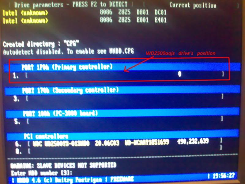

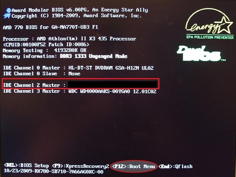

Hello, this is my second post did not have time to say hello. My name is Peter and I come from Polish. My English is how to say, lame and are backed by some with the help of google translator. So that, I'll start by saying that I drive in the settlement of my best friend, and frankly I do not know what his original story, so I will start from the moment when the disk came to me, this drive comes from a family WD Green series its full model is WD15EADS-22P8B0. Well, when you connect the drive to your computer, the disk accelerates normally, you can hear the calibration heads, shoulder knocks heads, feel normal vibration, but as you can see in the attached picture
The disk is now detected in this way, Please note that the picture shows a different picture than have charging BIOS on the computer, so I just wanted to show what it looks like.
Programs like mhdd in this way detect disk :arrow:
. :arrow: and in this case also wanted to show me how it looks Drawing on a picture taken from the internet.

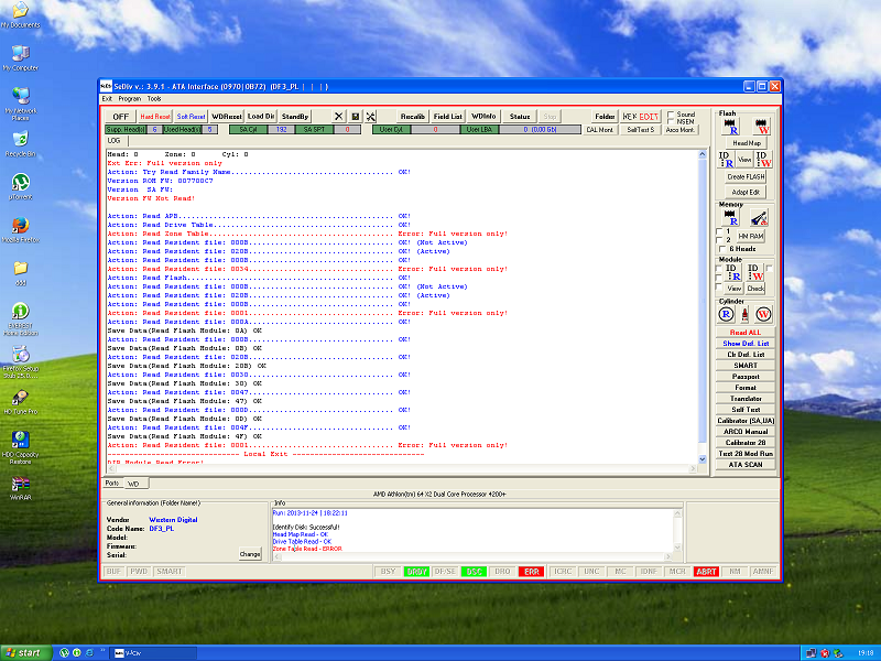

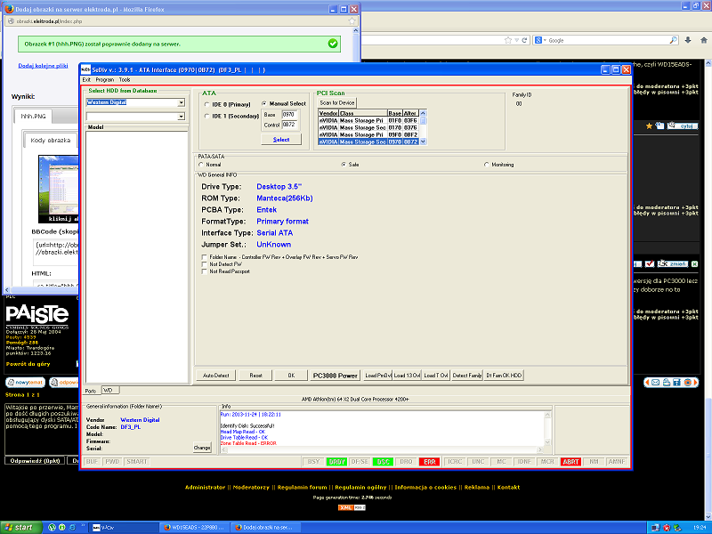

Next, flipping through the internet I came across a program SeDiv WD DEMO version 3.9.1, which among other things to detect the drive also helps to detect loading the module SA, Flash and others, and what you see on the pictures attached:

Spildit, those MODs are ROM MODs, not SA MODs.
NazYura's MAVR utility was written for older drives, so its checksum computation for ROYL MODs will always fail.

That log was produced by a utility that analyses ROYL modules as if they were pre-ROYL modules. That's why it only attempts to find MODs with single-byte IDs, and that's why it looks for the checksum in the wrong place.
Moreover, the utility is unable to access any SA MODs, which suggests that the drive's firmware is broken and does not allow SA access in the normal way, ie you may need "low speed" mode or "CHS" mode.
