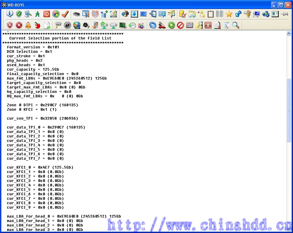

The aim of ARCO in this case should be changing drive format from 320GB/platter to 333GB/platter and obtainning a normal 500GB Mariner. You decided to keep the current format and reach only 480GB.
I didn't see in the video anything about the "selection portion of the field list". You don't know how to use it or the program doesn't have it?

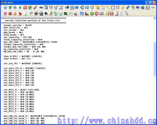

No friend, I meant this:

No, it is called as I said and as is written on the picture.
It displays the setting for TPI, CAP, etc. one should make BEFORE running ARCO. Otherwize the default values are used and the ARCO typically ends with an error . That is why your videos show how drive starts ARCO, but never show how it completes successfully.
