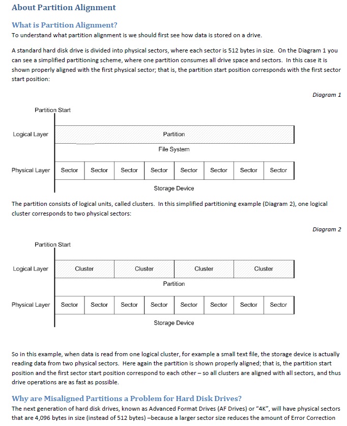

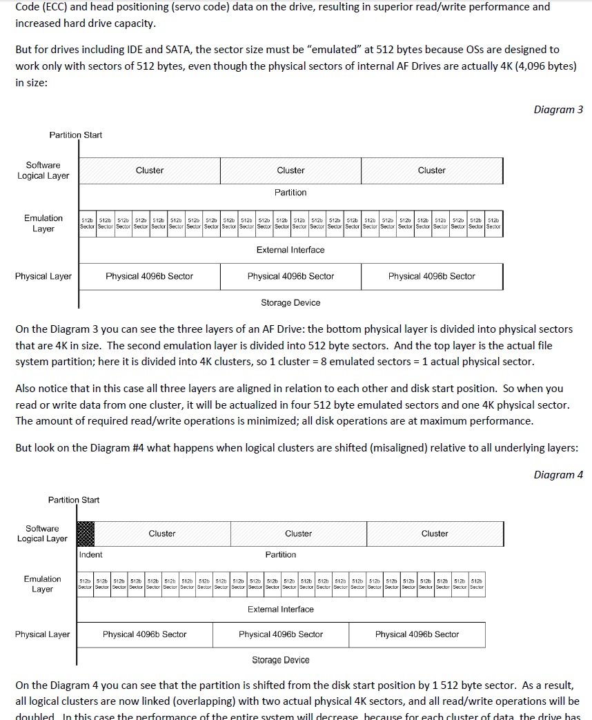

havent looked at it much as I dont plan to play with the disks in these PCs but the docs are pretty interesting if you havent seen much about AF and want to get a handle on it. The disk test in the docs is particularly interesting as the speed is a dramatic change if the alignment is correct.
from "Why alignment of extended partitions is not necessary - statement.pdf"
Simple test:
1. Writing 15GB of data (154 files x 100MB each) from ALIGNED PRIMARY partition to UNALIGNED LOGICAL partition, located within UNALIGNED EXTENDED partition. Complete time: 23 min 53 sec.
2. Writing 15GB of data (154 files x 100MB each) from ALIGNED PRIMARY partition to ALIGNED LOGICAL partition, located within UNALIGNED EXTENDED partition. Complete time: 14 min 48 sec.
3. Writing 15GB of data (154 files x 100MB each) from ALIGNED PRIMARY partition to ALIGNED LOGICAL partition, located within ALIGNED EXTENDED partition. Complete time: Complete time: 14 min 49 sec.
a good explanation of alignment and Advanced Format is in the docs:

Dell's "Advanced Format HDD Detection Tool Utility" appears to rely on the content of Identify Device data words 106, 117, 118, and 209. AIUI, reporting a drive's AF status is optional, so AF drives may not always identify themselves as such. In fact I have seen this behaviour in some WD and Samsung models, IIRC.
I'm also wondering whether WD's alignment jumper (7-8) is always reported. This jumper adds a +1 sector offset to each LBA. If the jumper is not detected by the software, then a drive may appear to be non-aligned (boot sector at 63) whereas in fact it may be aligned (logical sector 63 = physical sector 64 / 8).
Another question I have is in relation to FAT32 volumes. Aligning an NTFS volume is relatively easy (by locating the boot sector on a physical sector boundary), but FAT32 volumes have FATs which don't necessarily end on a 4KB boundary. Therefore ISTM that one would need to ensure that the root directory is aligned to a physical sector (by padding the area beyond the second FAT), and that the cluster size is a multiple of 4KB.
