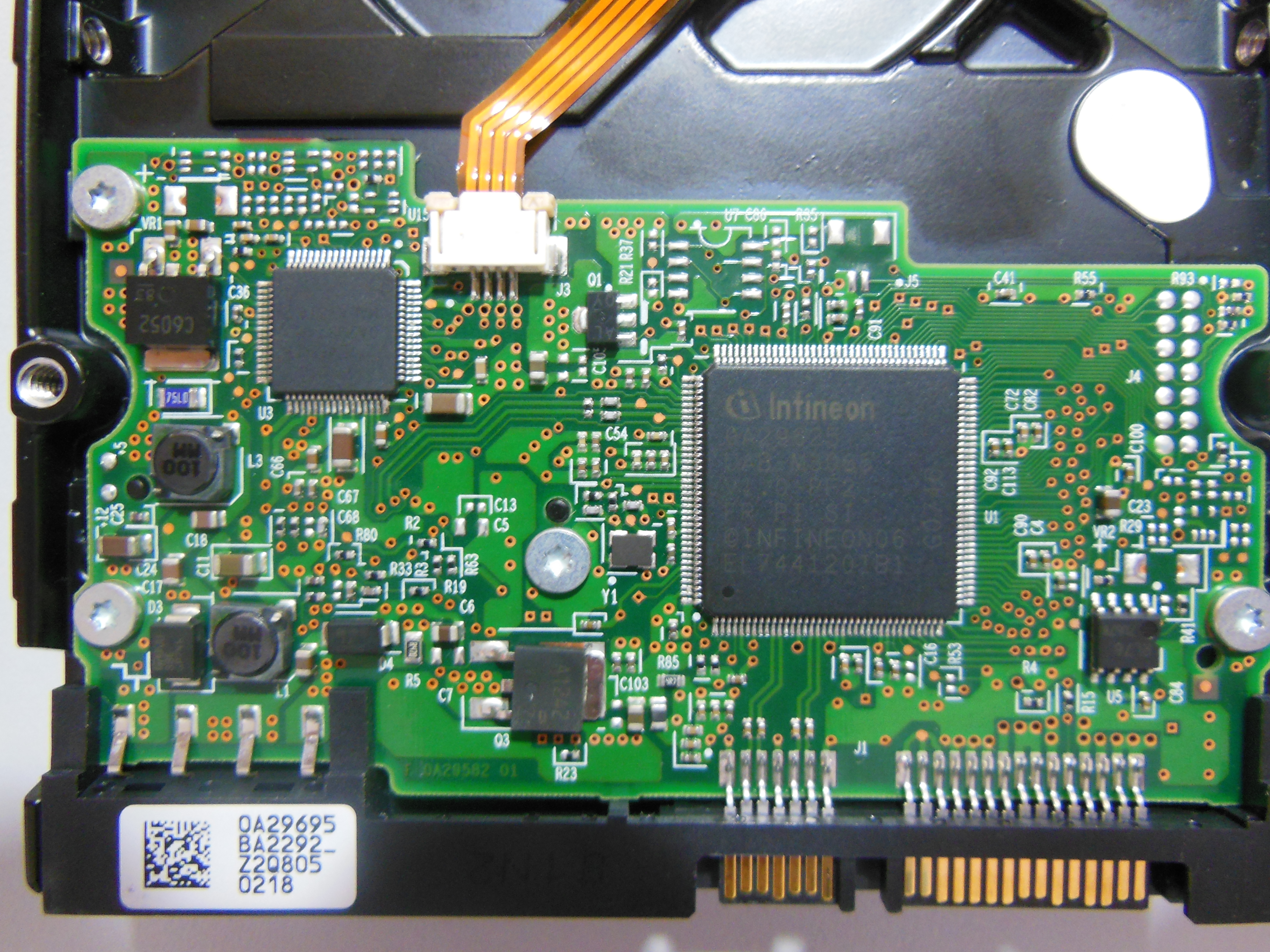

Actually it was opened in a clean room thanks for concern, and these are the pictures of the pcb.
File comment: PCB from hitachi HDS721680PLA380

I was reading your article and appears to be the R5 resistor because it's not measuring 0.47 ohms and all the test points on the HDA are okay. I'll try to find help with someone that have more knowledge about electronic. Also i could try migrating the ROM of the PCB to a donor one i think.

I would measure the resistance between ground and the preamp side of R5, with the board on and off the drive. This will tell you whether the preamp is shorted.

Maybe i'm wrong but it measured around 41 kohms, btw. Just now i repaired another pcb with this one (i migrated the D3 diode to get another pcb working again) and with the repaired pcb that successfully works the hard drive is doing me the same. I haven't migrated rom but the hard drive is suppose to do something different as i know with some experience.
I'm starting thinking about the preamp of the drive.

What voltage do you measure on each side of R5? Is it +5V on one side and 0V on the other? What is the actual resistance measurement for R5?

i have +5v in both sides of R5, and the resistence cannot be measured, i have continuity on both sides of R5 looks like open.
I measured on other pcb that i have and it's different +5v on one side and 0v on the other side of R5, also the resistance it's near 0 and i don't have continuity.
Looks like the R5 is not working well.

However, if R5 is open circuit, and if there is no short circuit in your preamp, then replace R5 with a 100mA fuse, or just swap the PCB and transfer the NVRAM.

I got a donor drive with the same specifications, swapped PCB and also ROM and still the same with the known good PCB. The only thing that i can see now is maybe a preamp problem.
