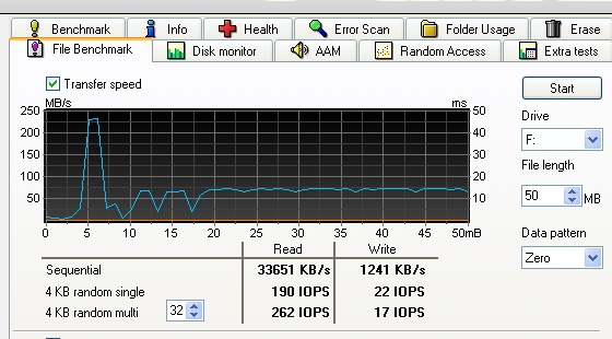

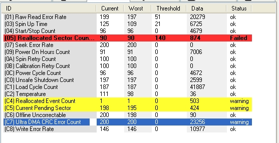

i had do lformat wz HDD LLF Low Level Format Tool 2.36
after that i had slow transfer rate in my wd 1 tera green
it write in about 2 mega/s
as in pic
what i can do
wait ur reply

it's internal sata drive
i had backedup my data to another hdd
but hope to repair that
i tried to replace the sata cable but same same
b4 the format it was fast but had bad sectors
after the format it become slow & no bad sector
thanks for ur reply & support
wait ur reply

Spildit wrote:
I would replace the drive by a new one, and also make sure that the PC power supply is of good quality and not a $15 USD cheap one.
Apart from that you would need specialized tools and knowledge to "refurb" the WD drive, in other words to get some more life out of it, but it will be way cheaper to just get a new HDD.
Regards.
dear Spildit
that drive out of warranty
the main problem failure from AC power it's cut off many time not from power supply of pc
it's work normal wz another 1 tera new one
i hope if u advice me wz any program to located that relocation sectors to isolate them
because no one can see them now hdd reg or hdd tune & they slow the drive speed
thanks for ur support
wait ur reply

Try MHDD from this site.
its same don't see bad sectors
or what i will do by it ?
