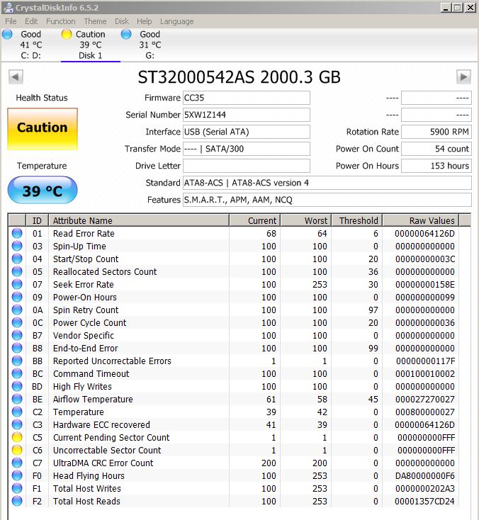

I am trying to clone a failed 2TB Seagate LP drive to aid in data recovery using HDD Raw Copy. Everything works fine (and fast) for the first ~397,000 sectors - then it slows way down and starts giving "unrecoverable read error" messages. I have tried several times and it always stops at the same location. I let HDD copy run for a while beyond this point and it never starts copying again. It appears the drive stops communicating because attempts to access the drive after that point are unsuccessful. However, if I power down the drive then power back up it once again becomes accessible.
I have recovered numerous files from those first 397,000 sectors - so it appears the drive heads and electronics are working - but why does it stop after reading 397,000 sectors? If there were bad sectors wouldn't HDD copy resume when it got to good sectors? Instead, it's almost like the drive "times out" and disconnects. Could this be an AAM/APM problem?

SMART data from CrystalDiskInfo attached.

Your drive has a problem with bad sectors. I would use a tool such as ddrescue to clone it. Ddrescue keeps a log so that it can resume after a stoppage. It also understands how to work around bad media. You can also clone in reverse.
