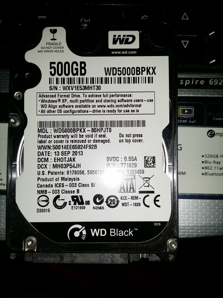

Hi guys,
i want ask you if there are tools that can fix a problem of my wd hdd 2.5" 500GB black.
The problem can be viewed on YouTube at the following link: http://youtu.be/VSPZd8EZoUs i think is a stuck spindle problem.
I not want open hdd becouse it have warranty but i want can try to recover data from it.
The hdd it was formatted into ext4 system with ubuntu for only data, not os installed.
Thanks a lot for the help

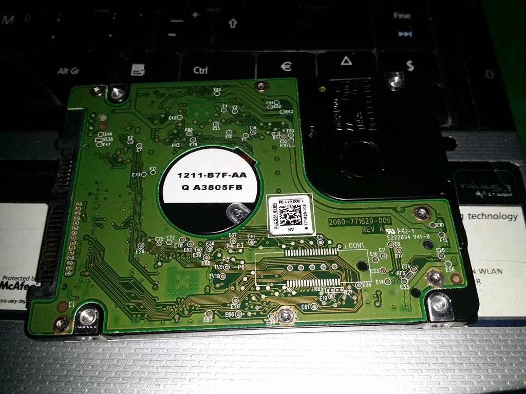

This problem is PCB, ROM, no spindel. Attatch photo PCB front and rear.

Head stiction or detached heads. Not DIY unless you have head tools, clean room, good imaging equipment, experience, ect...

No, it's NOT a PCB issue.
It's stuck spindle, either heads stuck to platter surface or heads assembly mashed into ramp.

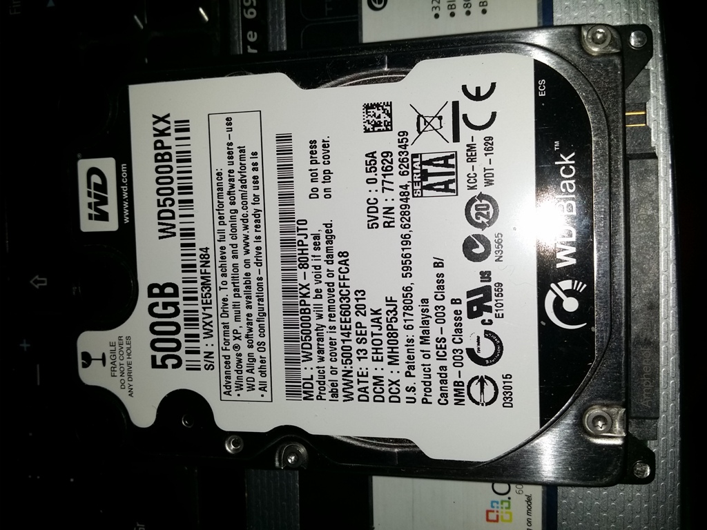

Hi, i've tried changing the PCB with that of another of the same type hdd (When I bought this hard drive I took two) and the problem persist.
Pictures 1 and 2 are on the disc that have the issue, while the photos 3 and 4 are those of hard working.
I thought so, thanks a lot.

I also believe that it does.
Do you think there is an attempt to unlock without opening it? I do not know maybe a magnet, freezer etc? I will not open it because it is still under warranty.

You're spinning your wheels changing pcb etc. You're wasting time and money.
This is definitely stuck heads and needs clean room work.
If data is valuable, stop experimenting, you're only going to make things worse.
Consult a good DR lab to get your data back.
I suggest Luca at http://www.ultrarecovery.com/
Good luck.
