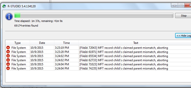

Quick question when i image with R-Studio, and i try to open a scan information i get this.
why? What does this error means.

It means that the MFT has errors. It could mean nothing in terms of data integrity but usually there is something wrong with the other parts of the drive as well (ie. overwritten data etc).
 Post subject: Re: Error R-Studio
PostPosted: October 11th, 2015, 18:51
When you save scan information be sure to keep track of whether you scanned the physical drive or logical partition. If you open saved scanned info the wrong way nothing will line up.
