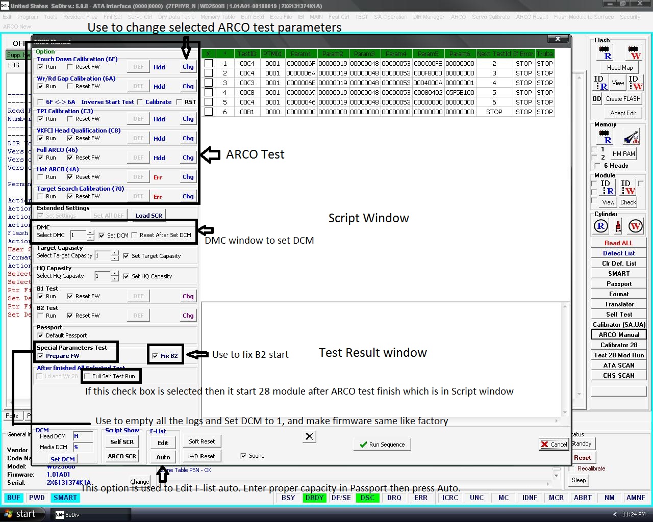

The newly release software of Sediv version 5085
Now sediv support Windows 7 and XP
The main features are

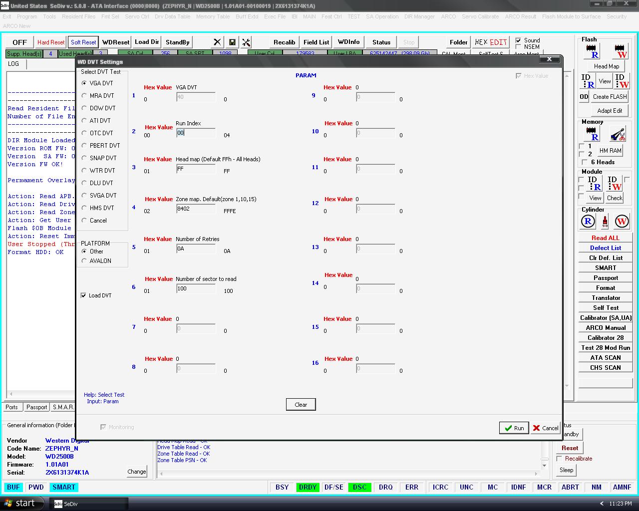

1. Added DVT ARCO
2. Add Manual ARCO with editing of ARCO test parameters
3.support ARCO from Script 28 module and from Sediv own loaded ARCO from firmware
4. Add option to Run B1 and B2 after ARCO (Selective)
5. Add prepare Flash and Start Calibrator ARCO 44
This function use to create empty rom which have empty adaptives and translator.
6. Add option Load LDR
7. Add all 19xx ARCO 44 and Other's
8. Firebird Head cut unlock
This is full video of complete refurbishment of a hdd with new manual ARCO.
From ARCO 44 to SF
Step by step guide
