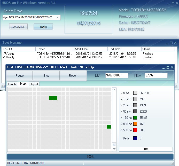

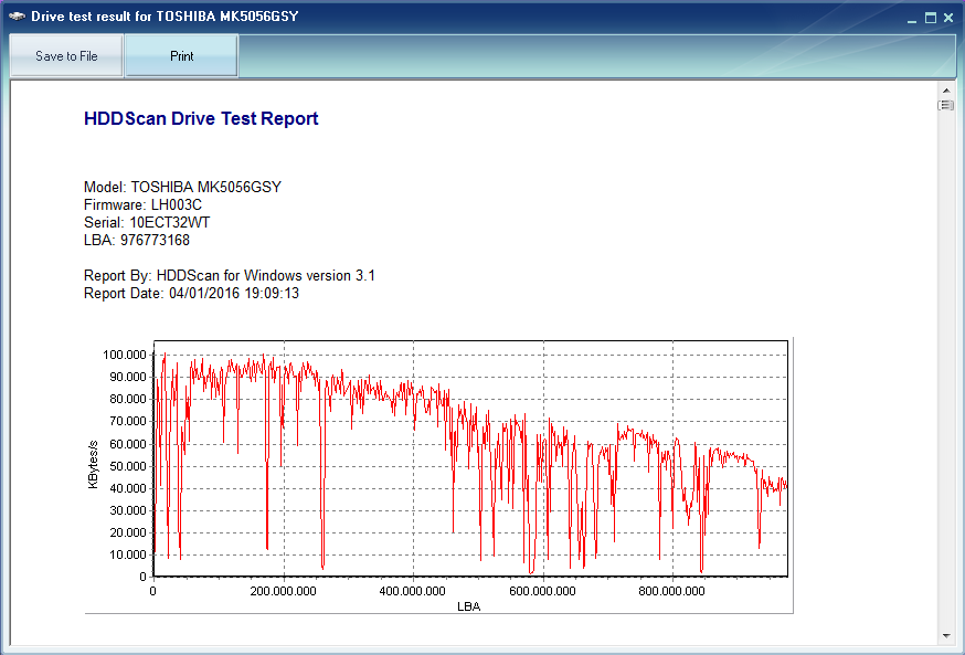

I have some problems with my HP, has become really slow and often starts with the hp notebook test "System Diagnostic F2" because of some problems with the hard disk. After several searches, I found HDDSCAN.
I decided to try the software tool "SURFACE TEST" as explained on line and these are the results:
I have two questions about. First: how should I interpret the results?
Second question: how can I remedy this situation ?

Hello!
Consider replace your drive. ( Weak head/s )
If data on partitions is accessible, get it ASAP.
Good luck.

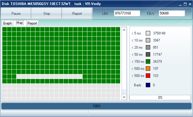

In these last days I tried to clean my pc from old datas and from unused software. I did a scandisk. These are the results...the test seems to give best results than the previous test.
What do you think about the results? Is the improvement non significant, or can we consider it significant?

Toshiba drive suffering from weak head/s.
Not recommended IMHO.

And....what about the better result of test? No opinion?
