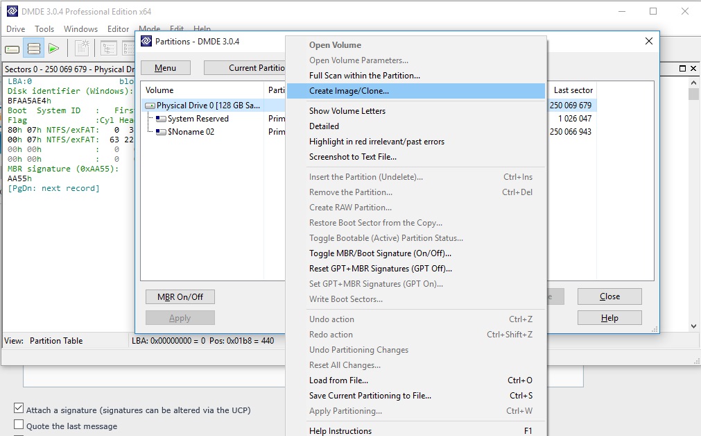

I would be taking an image of the entire disk before doing ANYTHING else... as already said by digitalferrett
Taking an image of the whole disk wont care if the partitions are 300GB or 30GB it will copy all the disk to a file so you don't run the risk of losing the only remaining potential copy of your disk (the disk itself)
attach a disk that has enough free space to hold an image of the disk. run DMDE and select the correct (problem) physical disk, click OK.
On this list right-click the physical disk and choose create Image/clone... select the file to copy the image to on your big good drive.
in Rstudio, you use this file as a source disk image..
