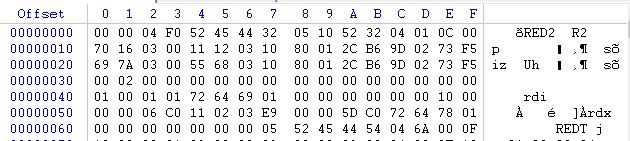

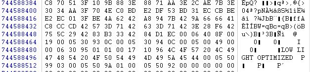

I have some .r3d and .prproj files to find in a raw recovery as the drive has been reformatted. We did get some files in a general scan, but there are more that we need to find. I need to write code to get these files. I can understand the initial file signature in R-Studio and can get the initial part of the file (I have tested it). But I am confused about how to end the code. If the code is left blank the full file is not recovered. I have attached the R-Studio xml set up file I am using and also the start and end of a .r3d file.
Any help would be appreciated.

In order to determine a signature you have to check and compare a few files
For example: in your case MAYBE the end signature might be
LOW\x20LIGHT\x20OPTIMIZED\x00\x05P\x99\x03\x00\x05P\x9A\x01\x00\x05P\x92\x00\x00\x00\x00\x00................
But again need to compare a few files to determine

Maybe other is more than 1 time appearances of that signature (end signature)
Open the file in n hex editor - like fzabkar suggested - and search for the end signature, if there is is more than 1 you have to put it too.
1 more thing have you tried to put the extra \x00 x8 to the end signature and use from: 0 Bytes ?
