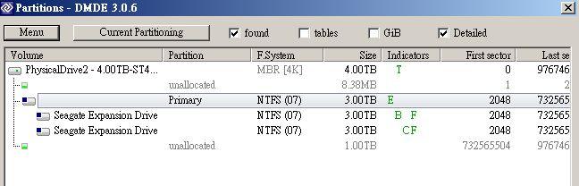

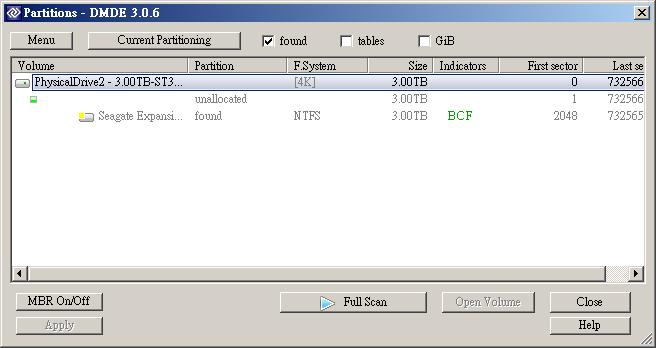

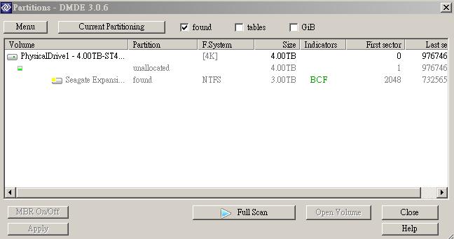

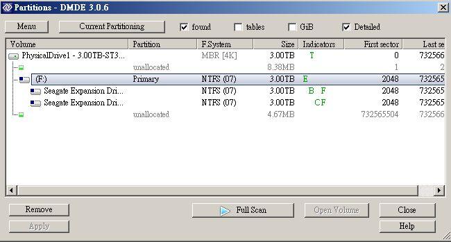

Yes, the partition seems a problem, why? is it possible to recover? (see the attached file 3T disk.jpeg & 4T disk.jpeg)

Neither drive appears to have a partition table in sector 0.
If you double-click the Seagate Expansion NTFS volume on each drive, can you see your file/folder tree? If so, and if you then expand the Root and recover one of your larger files to another drive, does this test file open correctly?
If the answer is yes, then r-click the Seagate Expansion NTFS volume on your clone and select Insert Partition (Undelete). You may need to choose Edit -> Edit Mode and then Drive -> Apply Changes. Then safely remove the drive and reconnect it. This will ensure that Windows re-examines the file system.

The file in disk could be recovered and open correctly, and I insert the partitioned (MBR)to the Segate clone disk as your advice. Windows could show the disk (F), however, it showed the disk needs to be formatted once I tried to access the disk F, do I miss any process when I recovered it?

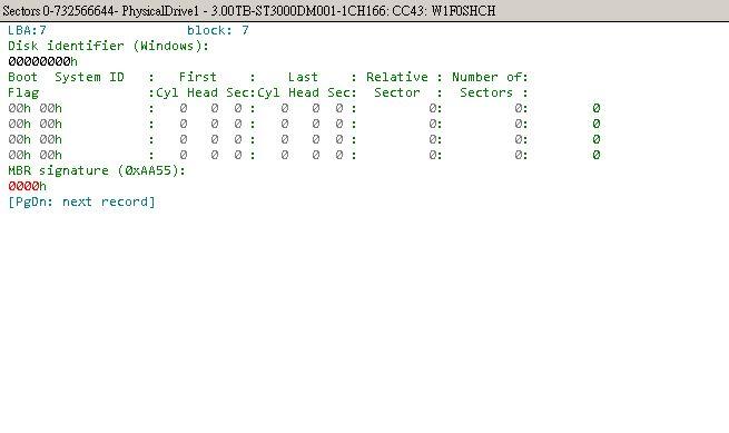

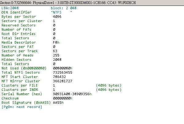

Could you show us the contents of sectors 0 and 2048?
Use Mode -> Hexadecimal/Text
BTW, please do NOT format the drive.

here is the information for 3T disk:
 Post subject: Re: How to access the good disk after use HDD raw copy tool
PostPosted: June 5th, 2016, 4:46
Posts: 17324
I don't understand. You are showing us the original "crashed" 3TB drive. I understood that the 4TB drive was the clone.
Anyway, you appear to have edited the partition table on the 3TB drive. Can you see the 3TB drive in My Computer now or are both drives giving "format" errors?
BTW you showed us LBA 7, not sector 0.

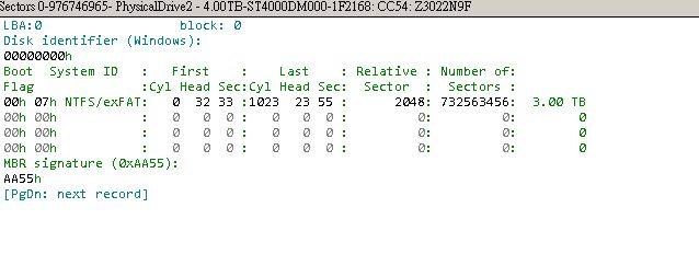

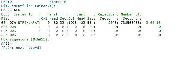

sorry for mistake. here is the 4T information and 3T sector 0 updat. 3T are format error,
4T disk could be accessed from Windows "computer", but it become a Segate disk (not Baffallo)and shown the capacity is only 2.72T. How to extend the capacity to original 4T?

So the file system on the 4TB clone is OK, but the file system on the original drive is not??? That seems strange. Maybe the Seagate drive has bad sectors in critical file system areas. I would examine the drive's SMART report with a tool such as CrystalDiskInfo.
To extend the capacity of the 4TB drive, you would normally go into Disk Management and create one or more additional partitions in the unallocated 1TB space. However, I believe that earlier versions of Windows could not handle 4Kn drives. To circumvent this problem, Seagate supplies DiscWizard (an OEM version of Acronis True Image).
To view and change the volume label, you could use the VOL and LABEL commands from a CMD prompt.
