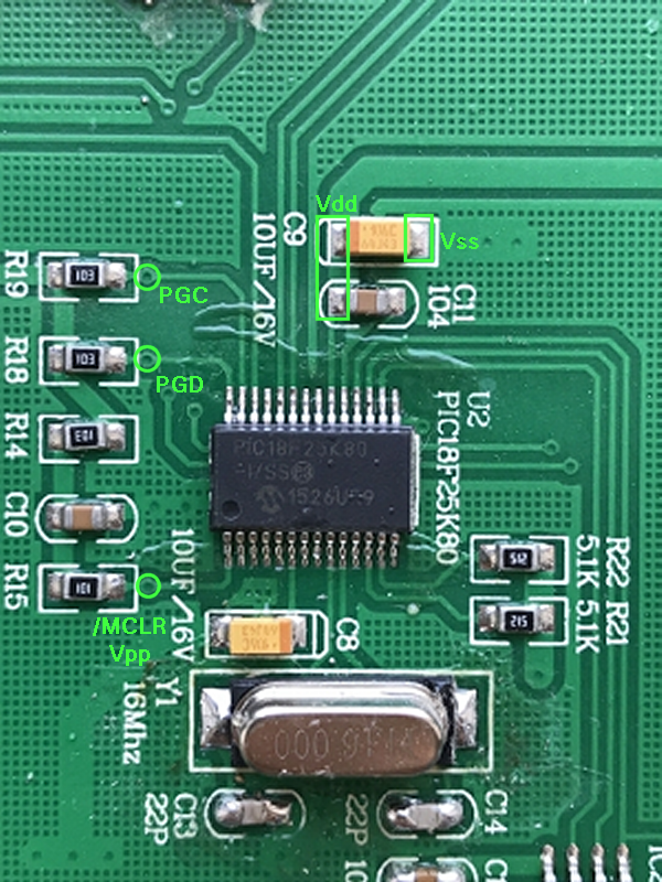

Hello~all :D
I am a newbie in the electronics,I would like to ask for help about how to read the data that in PIC18F25K80.
I am a student in high middle school and I try to learn something about electronics.I would like to know how can I read the data in PIC18F25K80? What instruments need I use? Or programming unit? Or any software?
This is the PIC18F25K80's datasheet:,please have a look if needed.
Hoping I can find the answer here!
Thank you in advance!

I would trace the PGC/PGD/MCLR pins back to an ICSP header, if it exists.
Be aware that the code may be protected, in which case you won't be able to dump it.

The code probably is protected ( one can hope ) by its rightful owner.

I have encountered many cases where uPs have been protected, thereby consigning a very expensive, and otherwise repairable, appliance to the trash bin. Very frustrating. Even worse is when the manufacturer or service agent tries to gouge you for an entire PCB instead of supplying a replacement IC.
