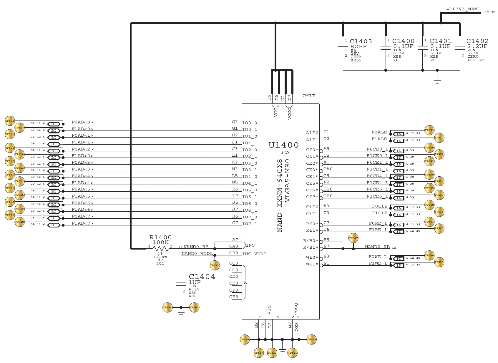

Just by way of example, here is a circuit diagram for and iPad 2:
https://elektrotanya.com/apple_ipad_2_a ... nload.html
If repair is uneconomical or infeasible, there is a JTAG interface.
Alternatively, here is the VLGA5-N90 pinout for the NAND flash:
