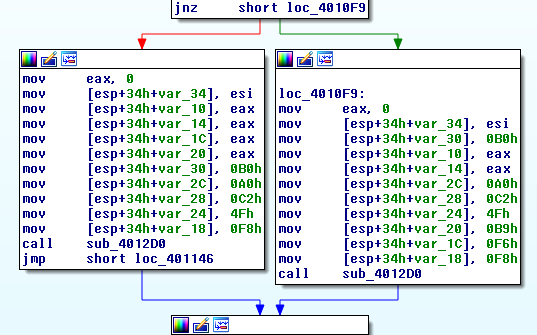

from what i can tell, the "super on" command has been the same probably since at least 2008. i want to say i found a much earlier reference to it but i can't find it in my history :(
from the victoria changelog from 2008-08-13 4.46b: "Added support for super-SMART for IBM / HITACHI ("factory" attributes)"
from http://forum.ixbt.com/topic.cgi?id=11:42461-72, there is a link to a tool which sends the command, ibm_ss.exe: http://vlo.name:3000/tmph/ibm_ss.rar
i attached an image showing the disassembly of ibm_ss where it sends the super on/super off - the command is clearly visible and the same.
i can't find any references to the clear smart vsc, however. just the super on/super off that *seems* to go back to ibm drive days.

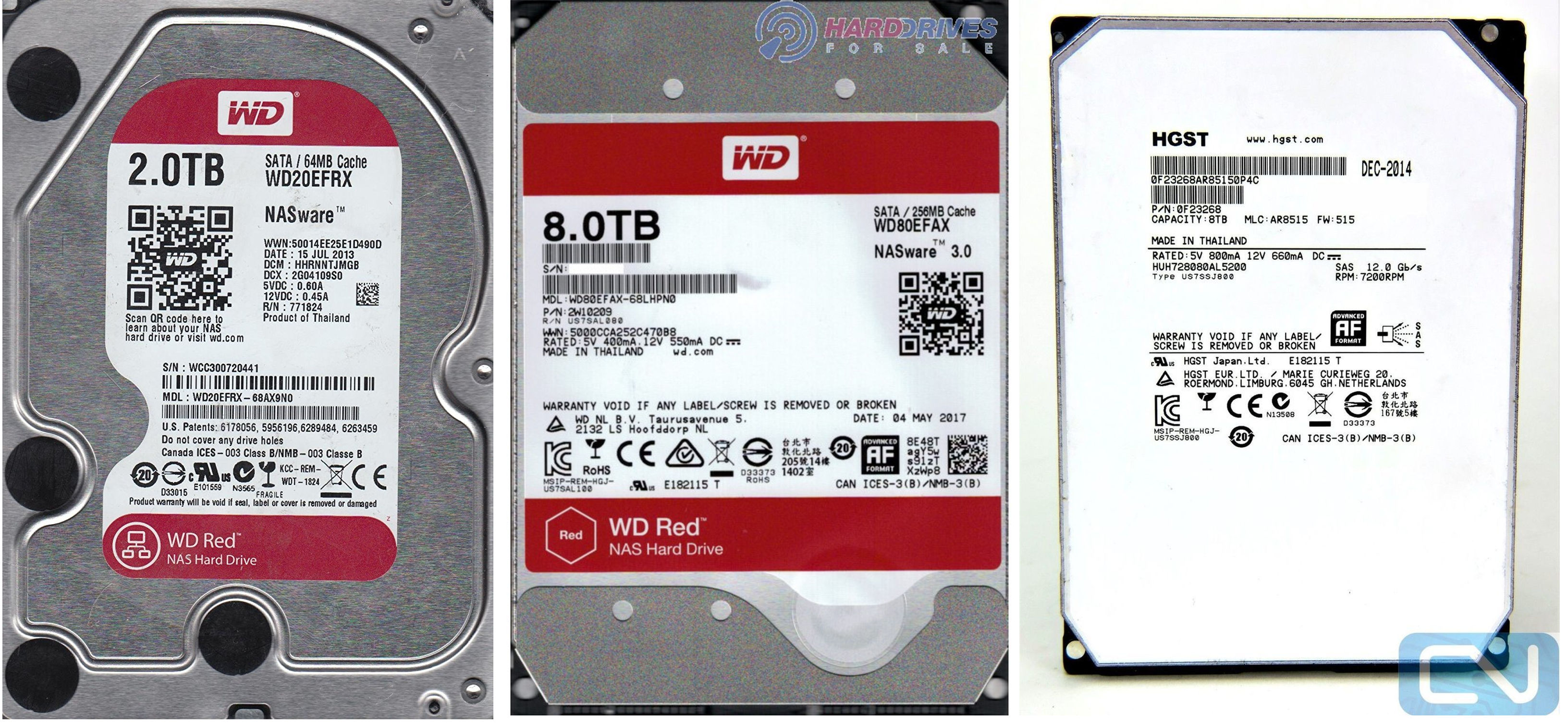

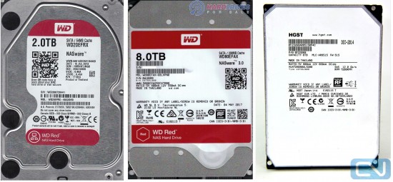

i did make a quick collage of an earlier gen wd red drive (WD20EFRX), my drive (WD80EFAX), and a hitachi helioseal 8tb (not sure of model). the WD80EFAX and Helioseal look identical, so that for me at least answered the question of it's a rebranded hitachi. this might be a "well duh" for the rest you :) although this is supposedly 5400 rpm while i only see 7200 rpm skus on the hitachi website...
