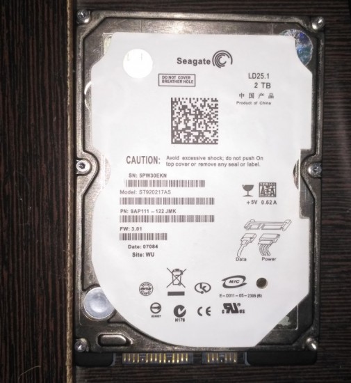

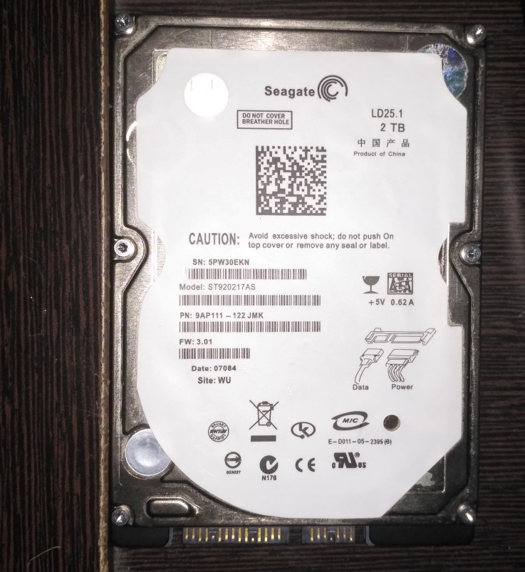

Bought a portable external 2tb drive which has turned out to be fake. The drive seemed to failing read test around 80GB mark. Formatting was also not happening.

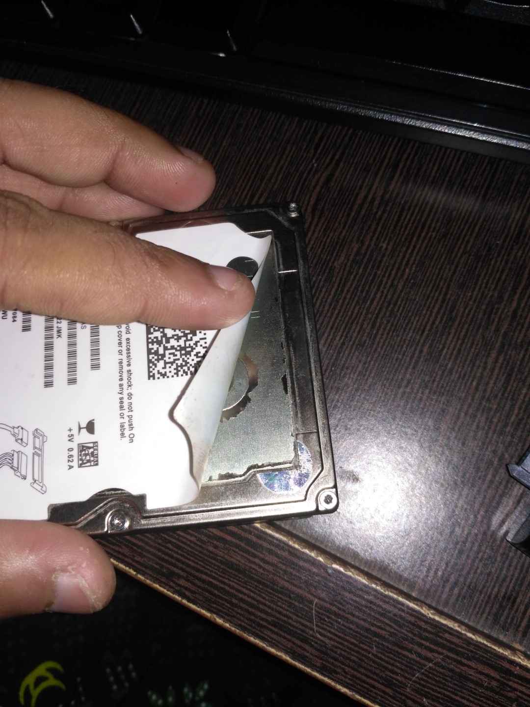

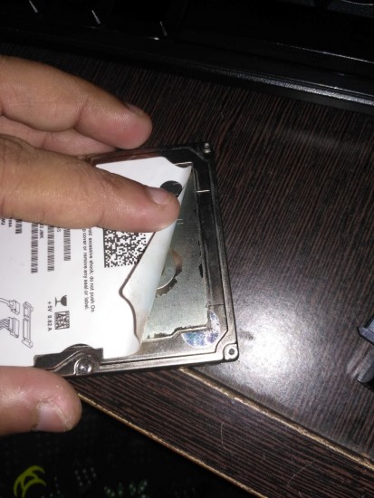

Removed the hdd, removed label sticker and the top cover, ran speed test. USB 2.0, the drive head nearly touched the spindle around 80GB mark. Single platter/head. The speed dropped abruptly and speed was jumping up and down after 60 to 70gb mark around 10MBps.

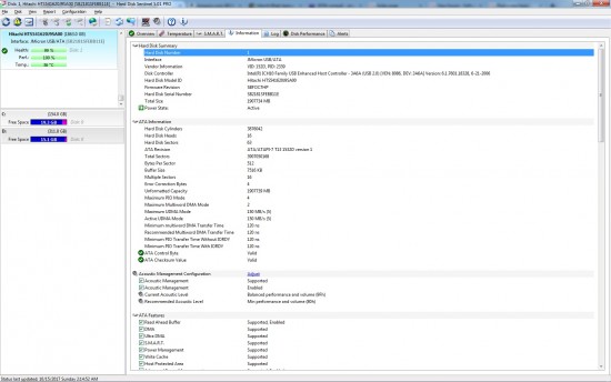

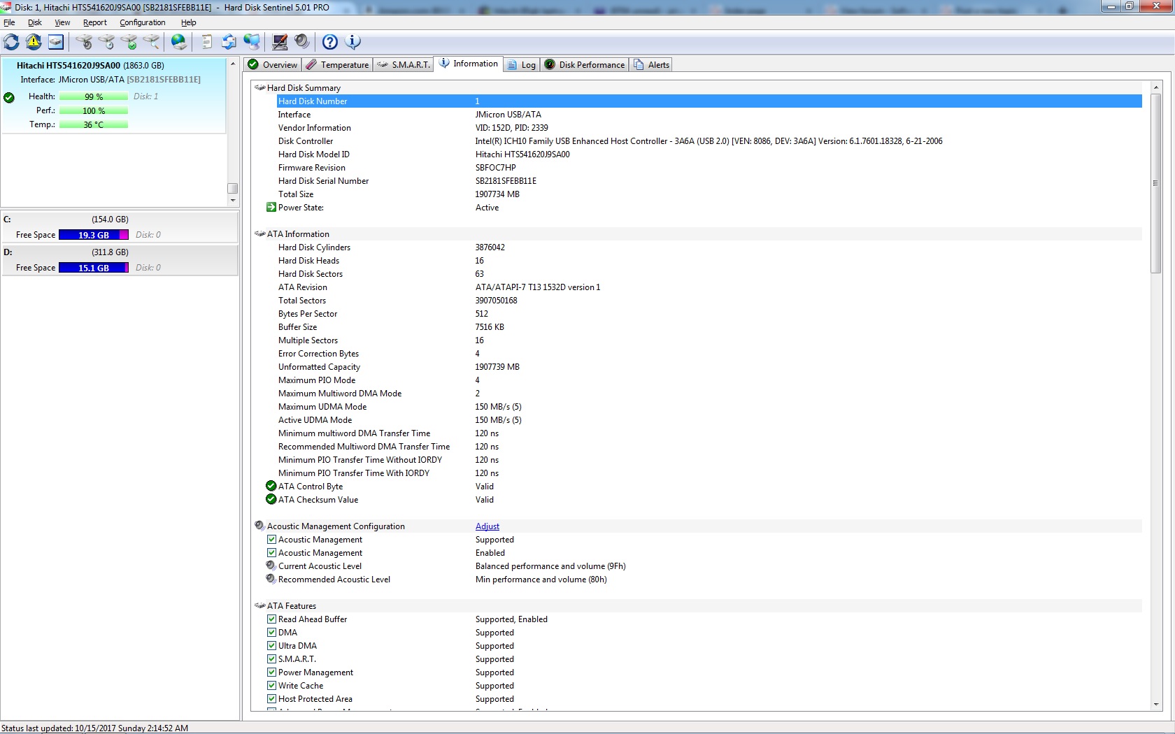

The sticker also came off easily and was fixed back perfectly. No sign that it had been opened. HDD sentinal shows it as hitachi but label is seagate.
yes, i have been duped thank you. Question is can i use this as a 60gb or 80gb drive??
I read the drive capacity restores to actual capacity when formatting if the edits were in some table. But i dont thinks thats my case. Thanks in advance. Attached are some pics including HDD sentinal drive details.

ST920217AS is a 20GB HDD.
http://www.seagate.com/docs/pdf/datashe ... s_ld25.pdf

The top label is covering the breathe hole...the drive is ID as a non existent Hitachi model, this drive is only good for a conversation piece.

The sticker doesn't fit right.
Here is a genuine ST920217AS:
https://catalog.onliner.by/hdd/seagate/st920217as

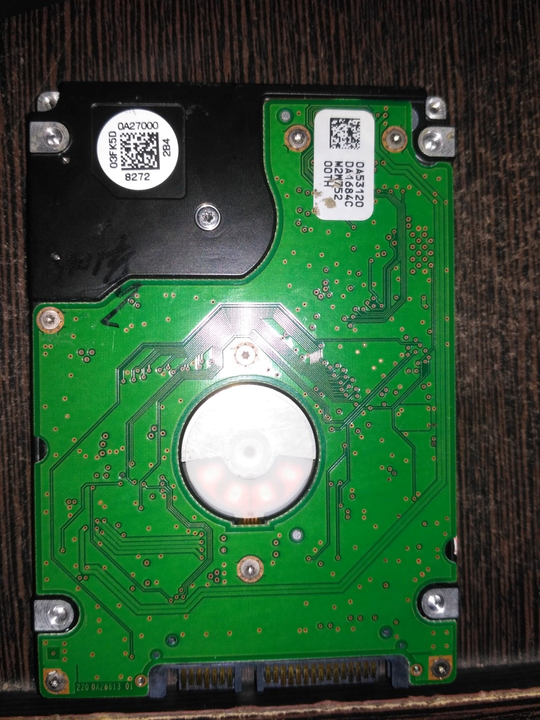

Could we see the PCB?
Edit: OK, so it's an 80GB Hitachi pretending to be a 2TB Seagate and identifying as a 2TB Hitachi.

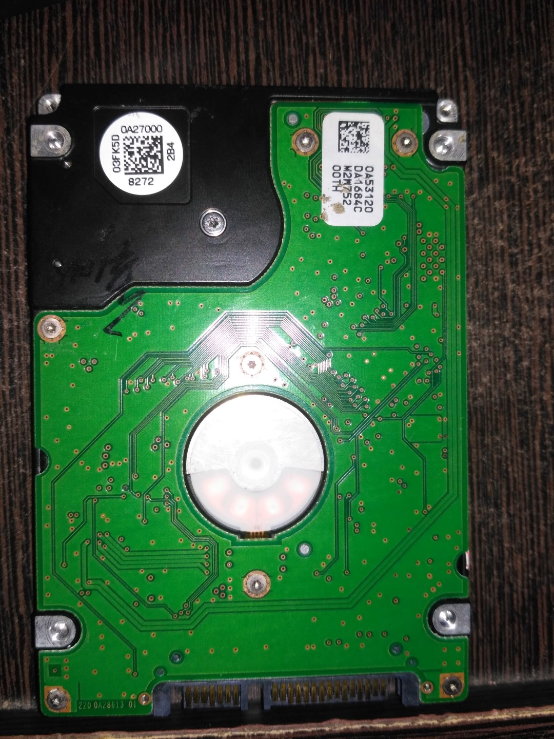

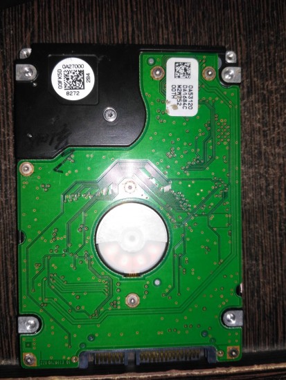

Attached is a pic of the bottom. From my search i have concluded it to be a hitachi but dont know what size or if i can reflash to the original firmware / drive flash. what a waste of 80$.
The error scan shows 0 bad sectors upto 80gb and it has 99% health. So was thinking i could use it for some purpose; even a 60gb would suffice.
http://data.stuartconnections.com/object/image?p=9333&i=1
ok thats great you found out. is there anyway i can get it to be identified as that drive?
pic of the bottom side attached.
And yes that seems to be the drive. Can i restore that drive details by any method to my drive and start using it??

Travelstar 7K100 HDD Specification:
https://www.hgst.com/sites/default/file ... spv2.1.pdf
    Number of sectors for 80GB model = 156,301,488
You could try to limit the capacity to 156,301,488 sectors by creating a HPA. I believe that Hitachi's Feature Tool should be able to do this, but I don't know how it will handle your fake.
https://www.hgst.com/support/hard-drive-support/downloads/legacy-downloads
BTW, uncover that breather hole.

The capital "O" in the middle of the sentence "Do not press On top cover" is a dead giveaway that the label is forged. Also the fact that it has a manufacture date of July 2006 which is long before any 2.5" 2Tb drives even existed.
