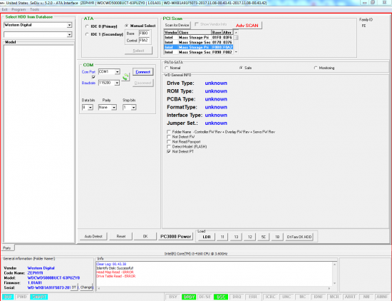

Hie ,I bought Sediv.When i try to detect WD disk ,I get Head Map Read-ERROR and Drive Table Read -ERROR.I tested with many working hard drives.Im learning HDD firmware. Please see attached pic

I'm not familiared with Sediv, but you might need to set up in BIOS as legacy mode
there are definitely other forum members in here, who are familiared with Sediv who can answer better than me

I would like to recommend ICCSYS for helping me to solve all my sediv installation.ICCSYS is very patient and was willing to help by remote desktop.Now my sediv is working.
But here is how i recommend how to setup sediv.
Steps (Do these steps consecutively when you want to activate)
1: Install windows 7 32 bit and activate .ensure that you fill USERNAME and REGISTERED ORGANISATION and COMPUTER NAME.**Do not install with username called "User" ,it will not work**
2: Install all you required drivers
3: Set screen resolution to 1280 x 1024 (if not available find it in custom resolutions for intel hd )
4: Install all your software which you may require before you create licence.lic.
5: Remove unnecessary usb devices
6:Shutdown and reboot from bootable flash of Hiren Cd with ghost software.
7: Create a GHOST image of the windows HDD and save .GHO on another HDD. (you can boot a live windows usb flash with ghost or use Hiren boot with ghost)
8: Restore the ghost image test if the Ghost image works.
9: If the Ghost Image is good then you can proceed to make Licence.lic for sediv and sehitachi.(keep the .GHO image safe)
10:Follow the normal way to email the .lic files and receive the activation files.
