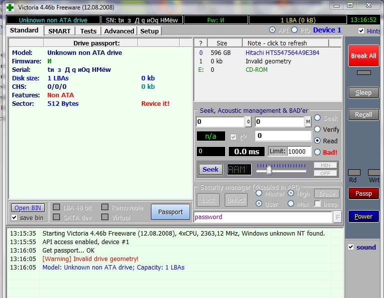

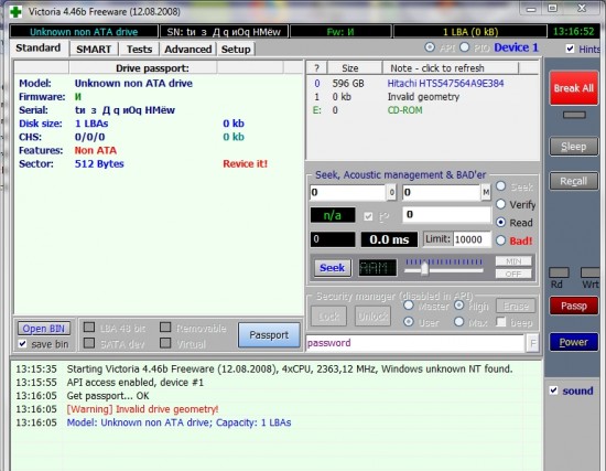

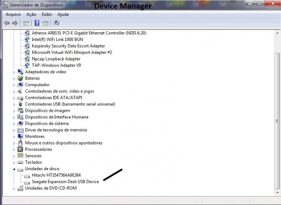

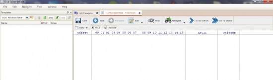

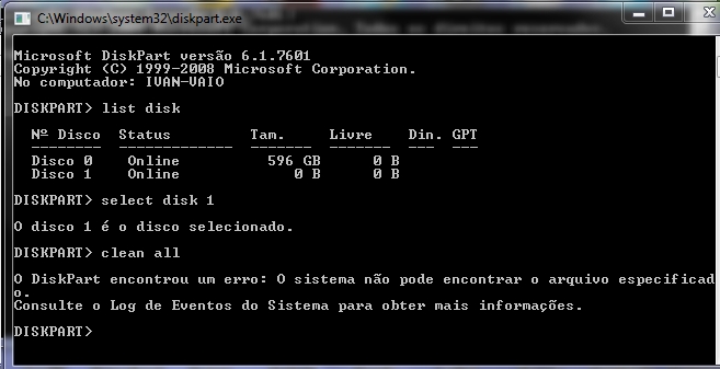

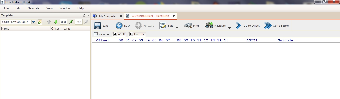

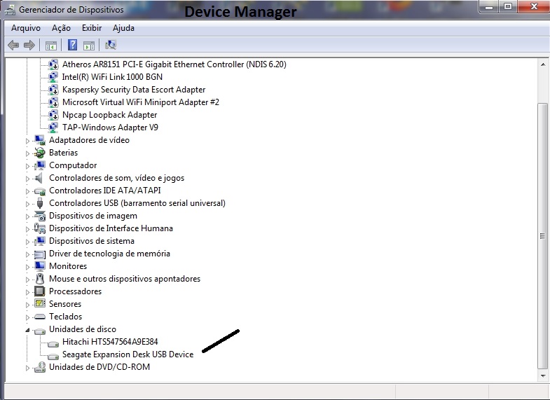

Hi, this drive was working fine. I shutdown my laptop and on the next day when I plugged it again, windows 7-64 did not show it. Device manager shows it as unknown device, not initialized. When trying to initialize it, an error pops up saying it could not do it because a specific file was not found. Then I used victoria and it reports as a drive with wrong geometry. Diskpart does not run any task to this drive because the same error as windows 7. Then I tried several recovery software and none of them sees this drive. There is no strange sound or clicks and it is spinning. I swapped it to another Seagate enclosure and nothing happened. What else could be done to bring it back? I really don't know. If anybody could help me out on this, thanks a lot.

Also you shouldn't be using Victoria with USB connected drives and API mode. To properly use Victoria you have to let it install it's direct I/O driver (most likely you will have problems installing it on 64 bit OS) and use PIO mode.

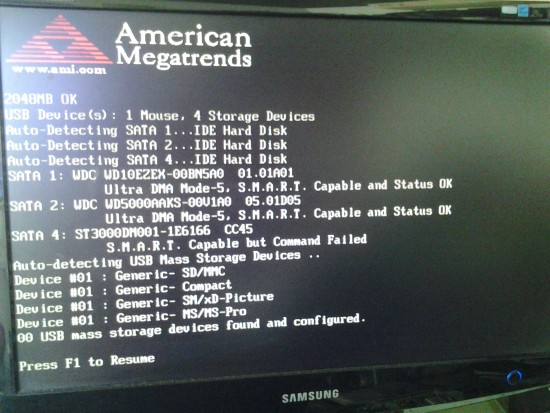

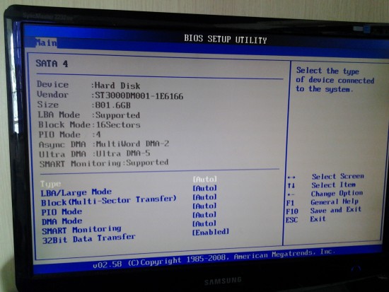

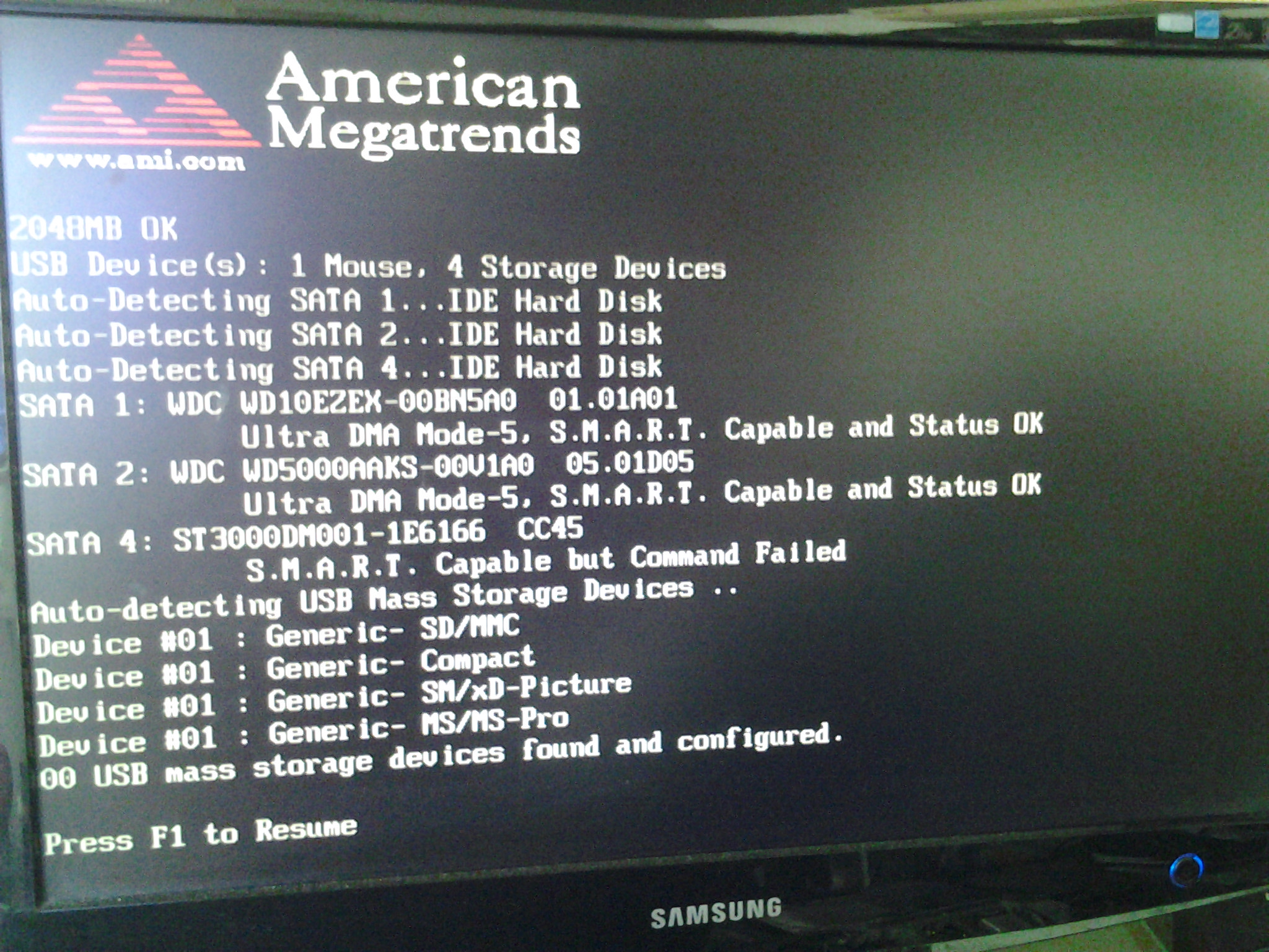

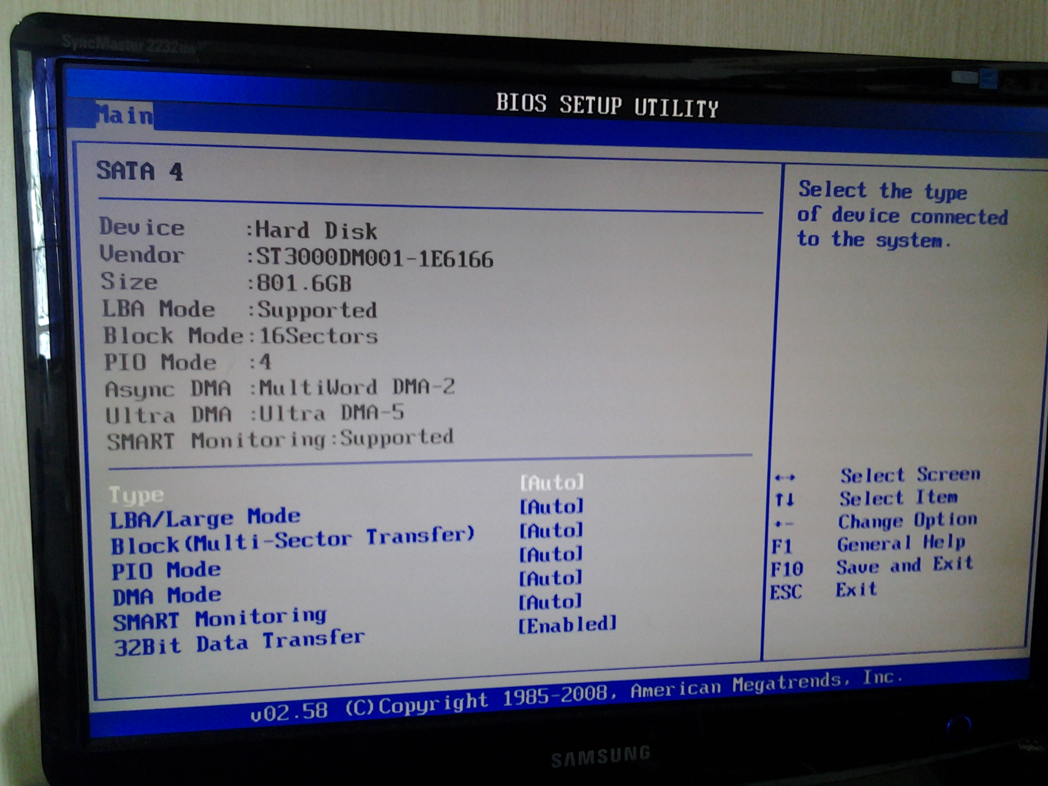

3) Yes I connected it directly to my desktop. Although my desktop motherboard has a BIOS of 2008, it could see the drive but with wrong capacity. Pls see attached pictures.

3) Yes I did. Although my desktop motherboard BIOS is of 2008, it could see it but with wrong capacity.

The bios is too old for this hdd....That's why is seen as 800gb capacity.
You need a better/newer motherboard to support it.

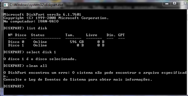

I know it doesn't help you, but I'm really curious why you tried to write zeros to the hard drive?

The motherboard is too old. I suppose if the drive is connected to a SATA port of a reasonably current motherboard, it would be readily readable; unless there is a 4K/512 sector issue, and/or part of the data is overwritten already.
I did not try to write zeros to the hard drive. I just run diskpart to see if it could be of any help. That's what it shows.

then why did you use the clean command in diskpart ? If it had worked then all the data would have been destroyed
Just to be clear, Diskpart Clean removes partition or volume formatting. For MBR drives it also removes hidden sector info and for GPT it overwrites the protective MBR. The device would then be ready to initialize. The parameter ALL writes zeros to the entire device.

Clean would probably delete boot sector and partition table. That would already be a bad move for him.
Clean all, from the help of diskpart, should write zeros to all of the drive. Absolutely bad move for him. :shock:
Yes, very bad! I am hoping he can clarify why that was attempted. Maybe some bad info on a forum needs to be corrected. But I guess we can't really fix the Internet :)

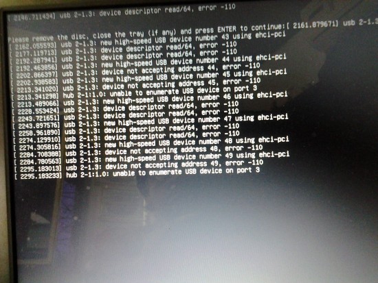

abolibibelot wrote:
@igirao :

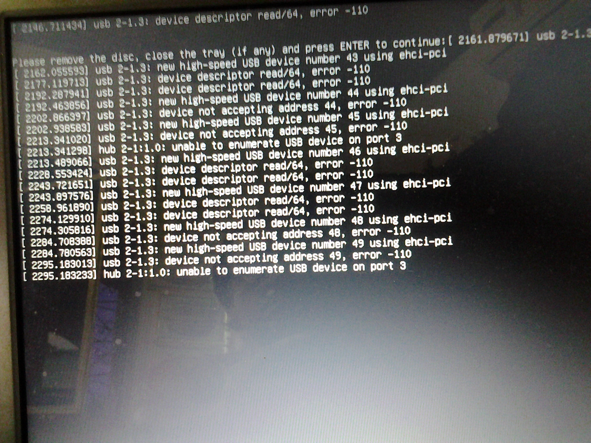

Did you try to connect it on a Linux system, and clone it or image it with ddrescue or HDDSuperClone ?
Yes, I did it. I used Kali linux and disk utility but it did not see the drive. Then I shutdown Kali and got this: pls see the picture.

Blizzard wrote:
I am pretty sure about that cmd. I was giving up the data. But as it didn't work, then working on recovering it again. Damn it! If it's not something mechanical issue as platters or heads or even controller board, it can be fixed. What if the zero track is bad? Then a dead hard drive?

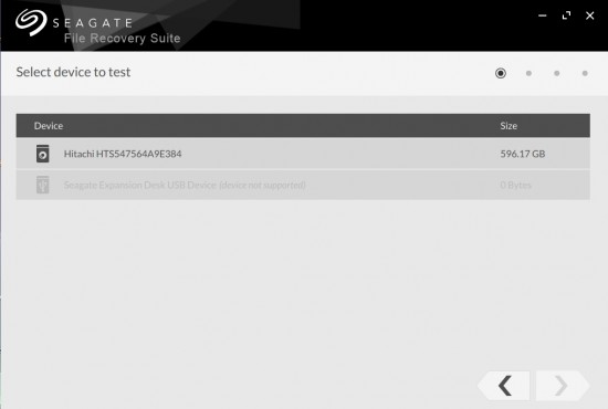

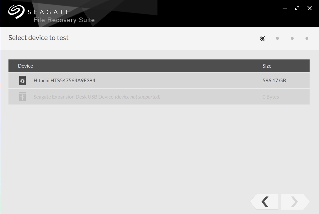

Not even Seagate File Recovery Suite program could see that drive.
