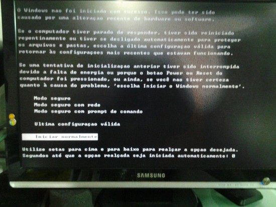

My wife's desktop has windows xp on a 1TB seagate hard drive. Suddenly it entered on a state of that black screen that has some options to choose from. But when it is there, the mouse and keyboard do not work and when the time is up it does not run the option is highlighted (Start normal). So it hangs. I tried to run the windows cd to try the recovery mode. But as the keyboard stays inoperative, it does not work either. I swapped the hard drive to other desktop and it is the same. Even clearing CMOS it does not work. I tested this hard drive on a hdd dock and it it's fine. I also tried it on a USB port but it keeps on a boot up looping. Does anybody has a clue of what is going on?

Does the Desktop have a PS/2 port? Perhaps a PS/2 keyboard there would work.

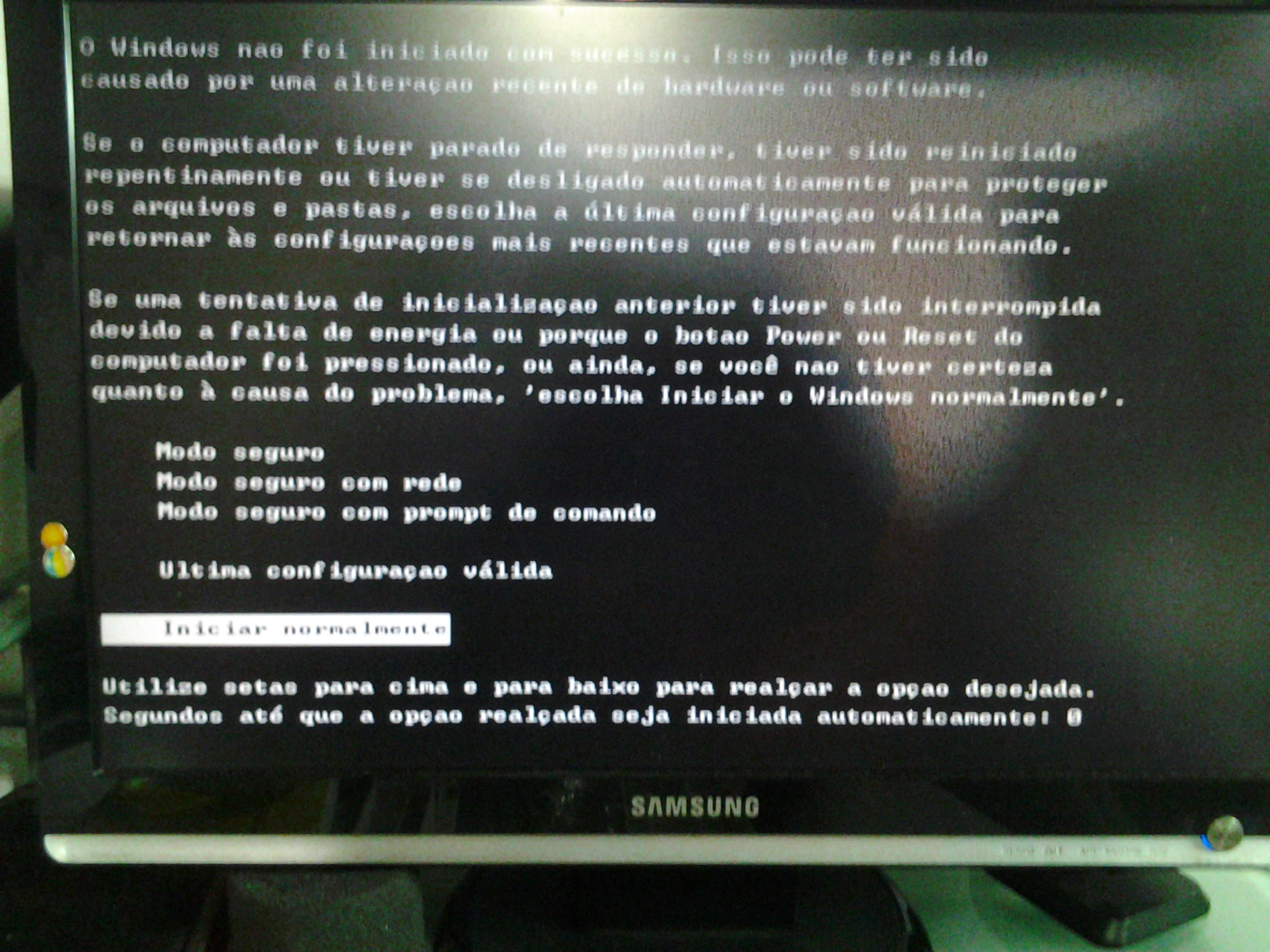

I used a ps/2 keyboard and it worked but whatever option I choose it hangs. I run Bart PE, keyboard and mouse just fine, and explored the drive. Could see folders, files, read and write. No problem. I guess it is probably corrupted OS. I know I can backup files and reinstall OS but I'd like to know what is causing it to hang. The easiest way is to backup files and reinstall OS but the cool thing is to find the root cause and fix it.

It is 99.99% a corrupted registry that prevents Windows XP from starting. I have three options:
1) backup everything and reinstall OS
2) Copy the restore snapshot manually and do a lot of copy and paste. (it could work)
3) Install windows 7 in update option to keep config and files and programs.
I am about to work with the third option in 32bits as winxp is 32 also.

What I have done:
went through system volume information and looked for the restore folder using ultimate live cd. Copied the files sam, software, etc and replaced those at windows/system32/config. Rebooted the system and still the same situation. attempted to use windows xp cd to updated and there's no option for that. Only install or restore in a cmd prompt. Tried to install windows 7 as update option but windows xp should be running for that, and not an option. So, as I had an empty drive (D) I installed windows 7, clean mode. rebooted system and to my surprise it worked but at the booting screen keyboard and mouse didn't work until windows had started up. I Can see, at the booting screen the two options to choose from: windows xp and windows 7 but cannot choose because of the keyboard issue not working till windows 7 starts up. On the booting screen, windows 7 is highlighted and when time is up it starts up. This is really weird! A PS/2 keyboard just works fine at the booting screen. If it was a USB issue, it would not work at all. This is so fu...weird! Now I have two issues: one is windows xp as said before and now is keyboard and mouse at booting screen. Damn it! :cry:

Before installing windows 7, I had restored BIOS to default and it didn't work. I have copied the files she wants to D drive but it is on the same hard drive, second partition. If I reinstall windows xp, I am going to have issue at booting. I can lose dual boot.

I said when in boot up moment USB keyboard and mouse are blocked and I cannot use them to highlight what OS to chose from. But when time is up windows 7 starts up because on the option it is already highlighted, keyboard and mouse are released (turn back to work on). Why only on boot up? That's weird!
Check if there is an option enabled in bios for legacy usb or something like that.
If I can remember, there's an option (enable/disable) USB support.
