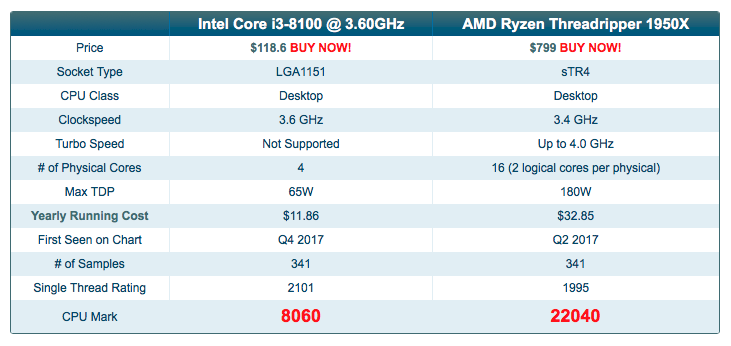

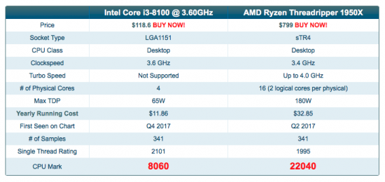

Thank you for your offer. But this won't be enough.
File comment: CPU Comparison
My i3 CPU would crack the password with a single thread in one year. Your CPU has a similar single thread performance, but you have 16 cores. So you are going to take about 23 Days. I need the Data before the 15.6.
That's why I started 400 Cloud Instances instances to crack the password.

My processor is 16 physical cores, but 32 logical with hyperthreading (provided the algorithm doesn't require more cache memory than it has for each thread).
So it might be more like 12 days. I can start it running and see how long it estimates.

After 7 hours with 400 EC2 instances I found the password. Job is done, the customer is happy.
Thank you for your offer. But even 12 days are .... well.... you bought the machine to work.....
But I don't understand why you said, that you have 32 logical cores that can crack the password twice that fast.
Ok, you have 16 physical cores. In my opinion you have no advantage if you take the full performance of one core of the other logical. Instead the processor has to stop one job, switch to the job on the other core and work on it. If the processor isn't under full load, I can understand that a second logical core can help. But if the physical core is under full load?
