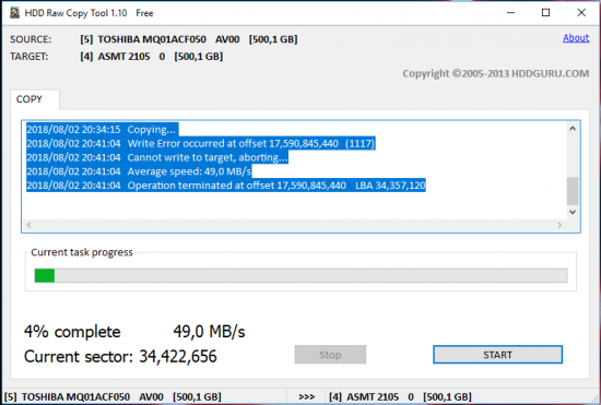

I need some help please.
I am trying to raw clone a Toshiba 500 GB HDD to a Western Digital Blue SSD also 500 GB.
The process keeps failing at 6% and I am not sure how to interpret the information (attached).
It's a write error which is strange because both HDD and SSD are identically sized and the write error occurs so early in the process.
Thanks.

It's probably because your destination drive (the SSD) has some kind of problem at LBA 34.357.120.
Try to repeat the procedure using some other drive.
