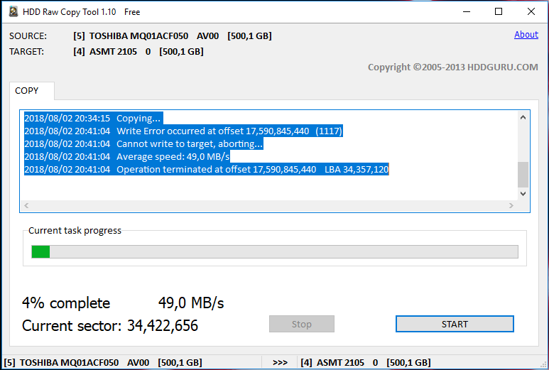

I need some help please.
I am trying to raw clone a Toshiba 500 GB HDD to a Western Digital Blue SSD also 500 GB.
The process keeps failing at 6% and I am not sure how to interpret the information (attached).
It's a write error which is strange because both HDD and SSD are identically sized and the write error occurs so early in the process.
Thanks.
Author:  northwind [ August 3rd, 2018, 4:45 ]
Post subject:  Re: HDD Raw Copy Tool Error
It's probably because your destination drive (the SSD) has some kind of problem at LBA 34.357.120.
Try to repeat the procedure using some other drive.
