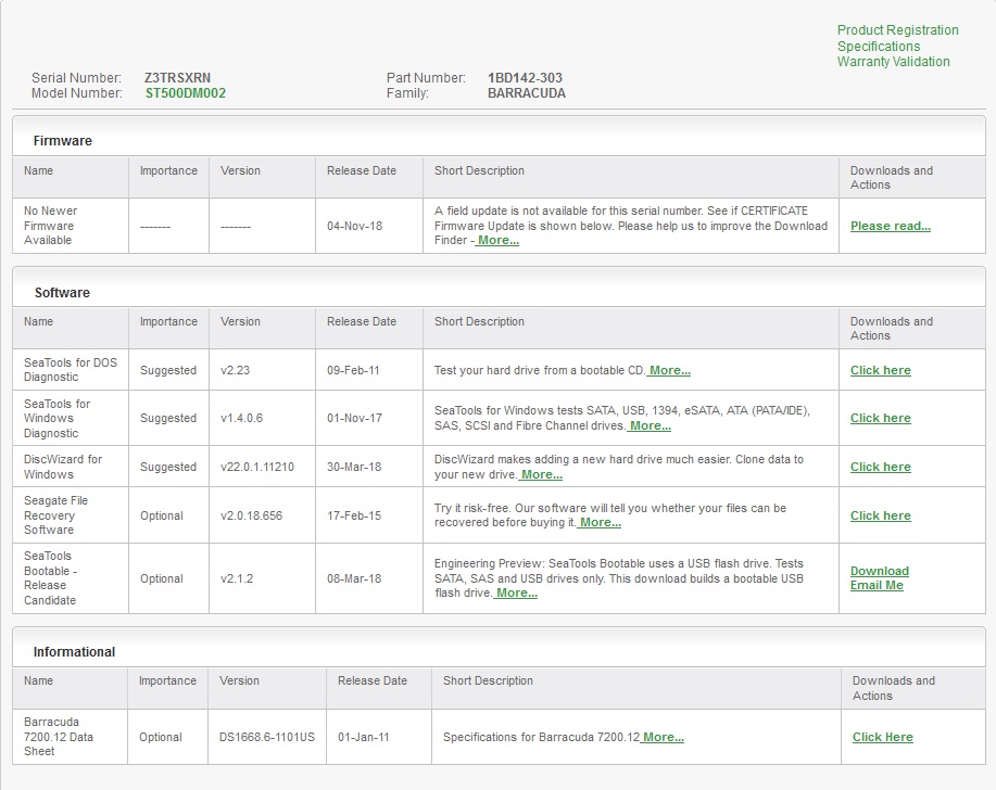

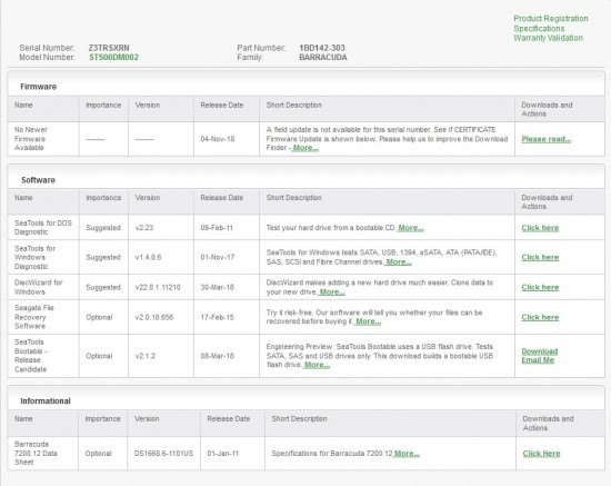

Device info:
3.5" Seagate ST500DM002 Barracuda 500GB
Serial: Z3TRSXRN
P/N: 1BD142-303
Firmware: kc48
STX: 720012(b)
Procedures that I made:
- Check Seagate Website to new firmware or update - Doesn't exist for this version drive.

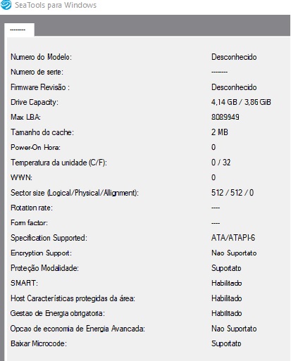

Seatools for windows:
- Quick test (DST Short) - Pass ! ok
- Generic short - failed !!
- Generic long full - failed !!
- other options - risk for loose data or impossible to do.
Seatools for DOS, via USB boot:
- System/application open appropriately, but after confirm "terms of use", application try to load drive, so FAILED !!
Advice: impossible to recover bad sectors, drive can NOT be read.

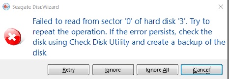

Seagate DiscWizard Tool For Windows:
- Clone device for another HDD - FAILED!! *** Message: Failed to read from sector "0".
- So, impossible to apply any other option.

More Information:
- Seagate ST500DM002 of 500GB can't read sector "0".Then, show only 3.83GB as total storage in the Seatools application.

File comment: Seagate website data available for ST500DM002 - Z3TRSXRN.
File comment: Seatool result with incorrect info !!
File comment: Discwizard Result FAIL info !

I bet your drive spins up, clicks and spins down.

Yes, it needs clean room work.
You need to have compatible donor and swap the heads. By saying "you" I mean someone who knows what he's doing and has the proper equipment, experience and knowledge.
It's not DIY in any case.

I know how to fix it and I've already told you.
The heads are gone and the drive needs clean room work.
Again, not what you want to hear, sorry about that.
If the data is important, you need to send it out to a decent DR lab. You can't fix it yourself :(
If the data is not important, bin it, move on and don't buy such a crappy drive again.
