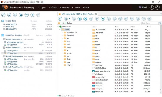

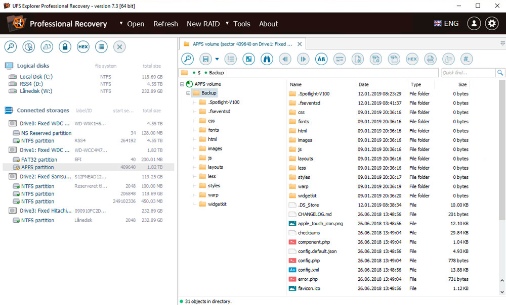

Latest UFS Explorer works great on encrypted APFS.
File comment: UFS Explorer Pro encrypted APFS

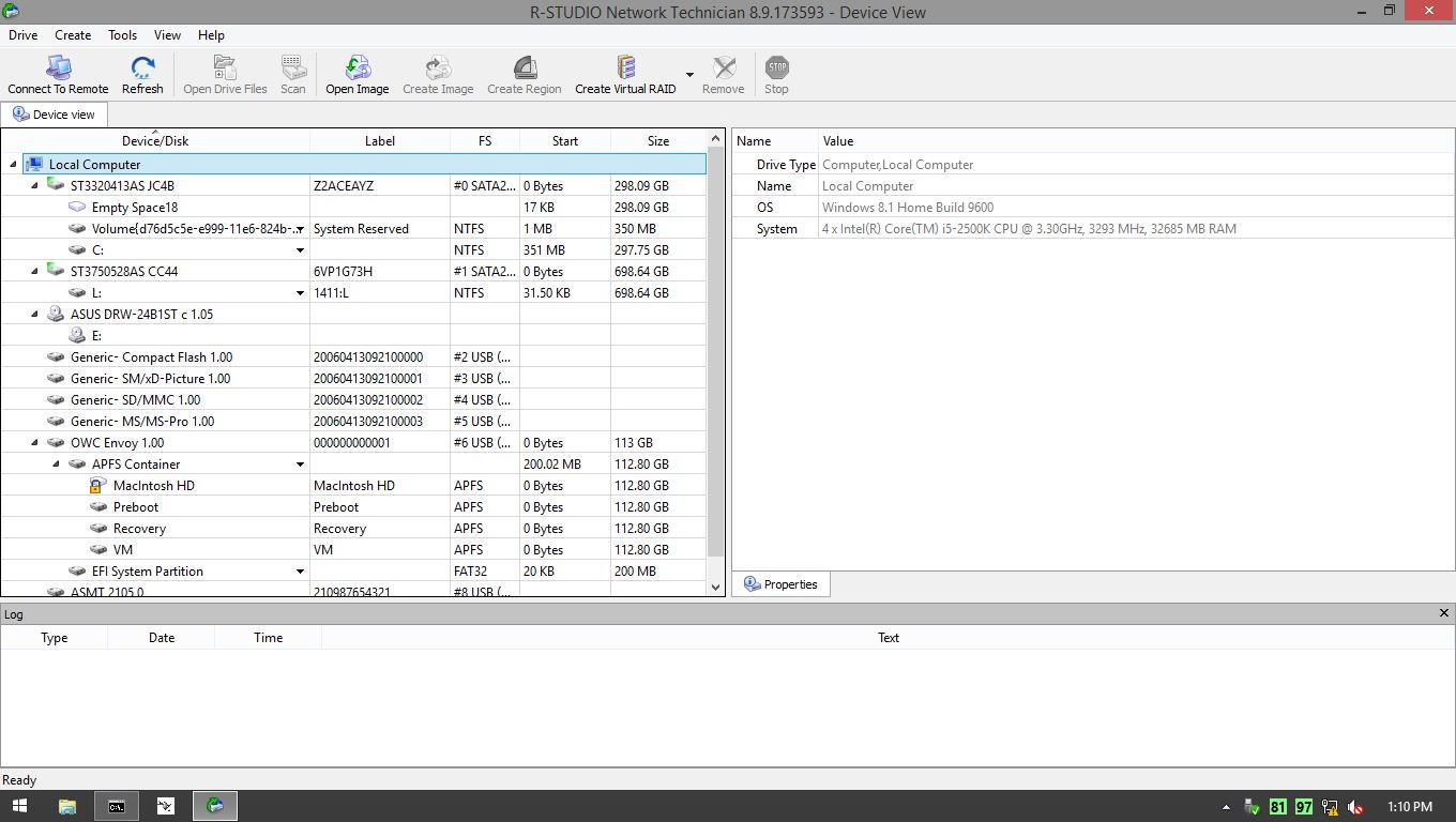

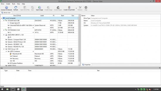

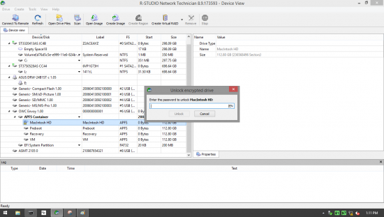

Here are some screenshots showing R-Studio 8.9 working on encrypted APFS!

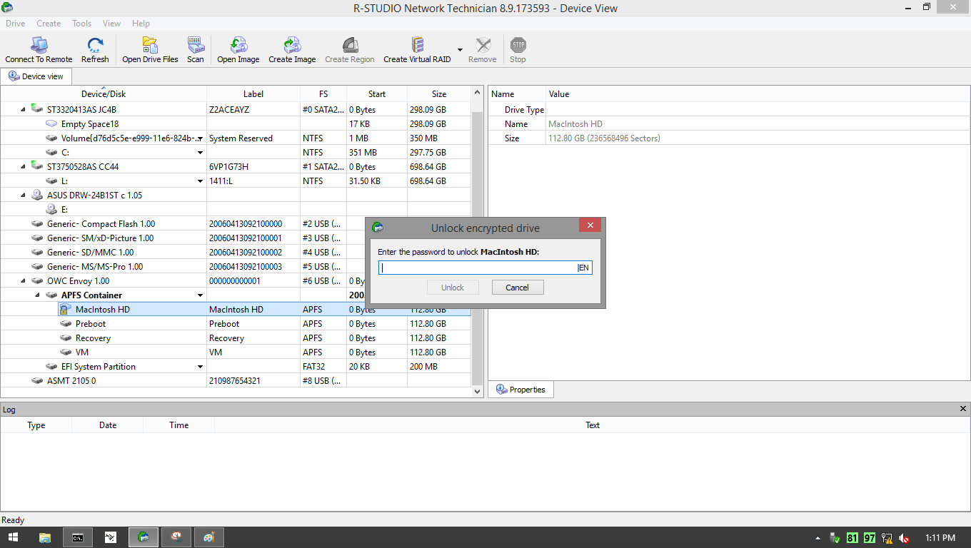

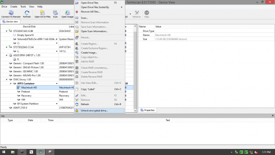

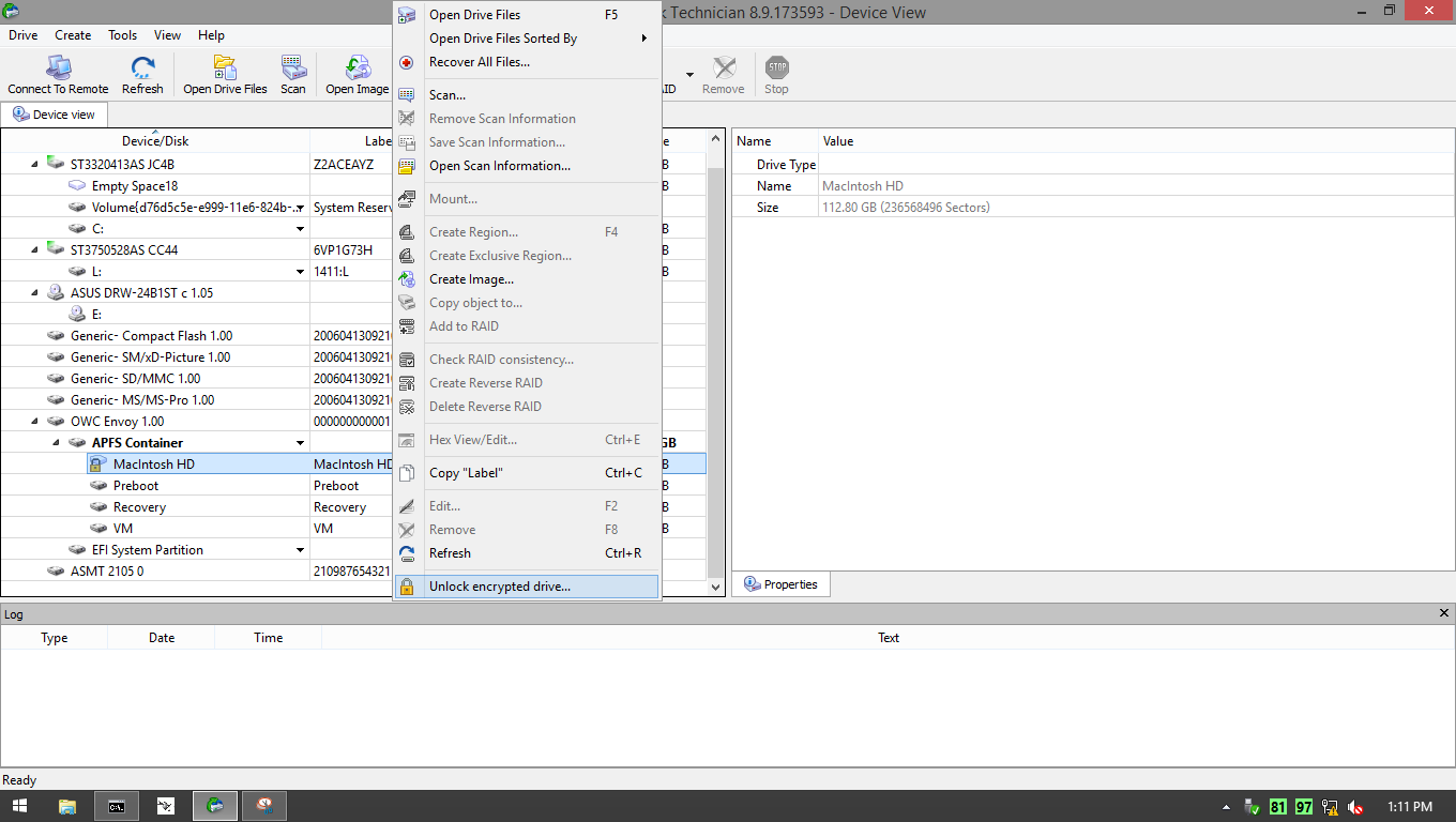

Option in context menu "Unlock encrypted drive"
Unlocking encrypted APFS...

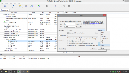

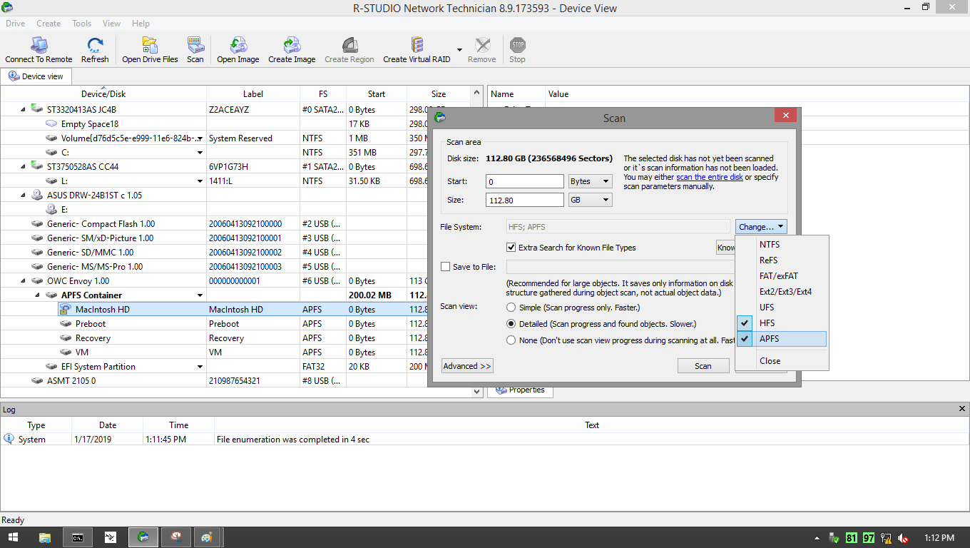

New filesystem option in scan menu for APFS.

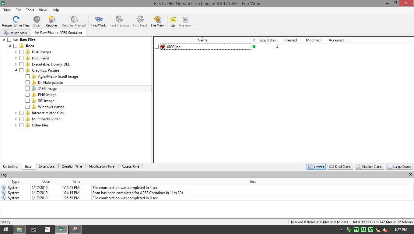

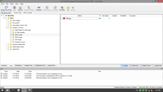

Unfortunately I did not get any results from raw file scan on encrypted APFS volume. Scan search by file type returns no user data, just generic MacOS files. Last I heard, SysDev has not figured out how to do this yet either for their product, can anyone confirm whether IntelliRAW works on encrypted APFS?
