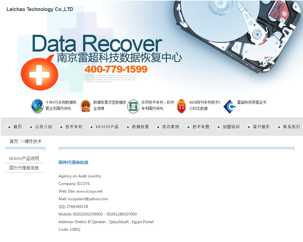

Hello
ICCSYS official re-seller of DD3000
Company: ICCSYS
Email: iccsystem@yahoo.com
ICQ: 626146286
QQ: 2766349138
Mobile: 00201002359000
