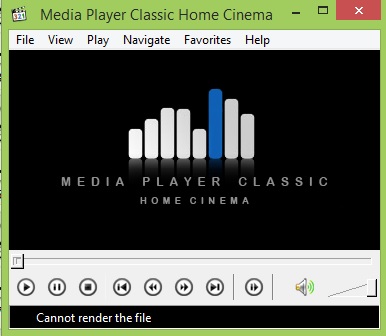

Hello Guys :)
Formatted or Deleted Video Files Not Playable After Recovered Files Successfully
File Size is Perfect but file is not playing with any of media player :(
Media Player Error (Cannot Render the file)
Anyone help will be Appreciated

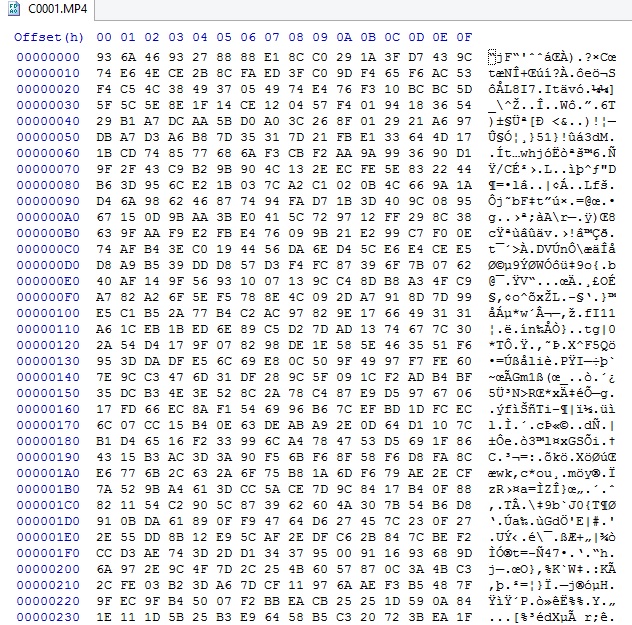

Please open file in hexadecimal preview. Make and share screenshots of first and last sectors.

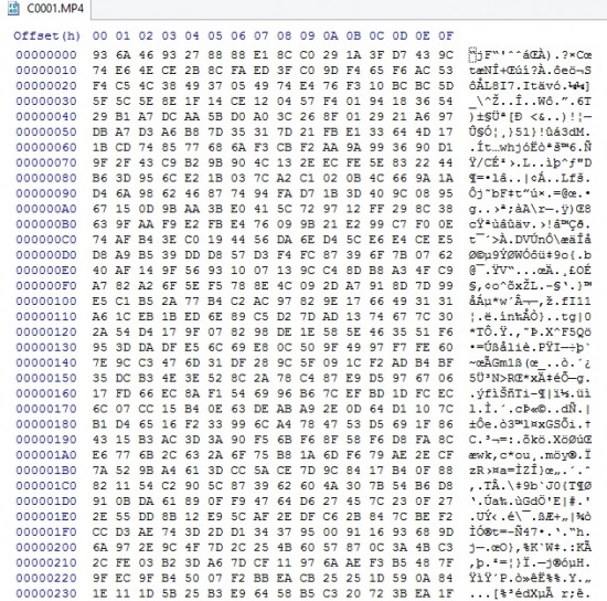

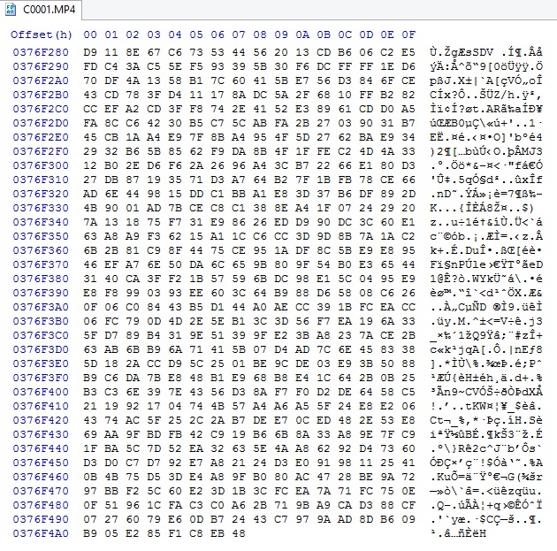

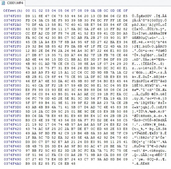

Attached HXD screenshots..
& this is deleted from Hard Drive
file type is .mp4 from Sony Camera

no valid video files data. sometimes overwritten,NTFS or FAT file system structure damage or encryption.
use RAW recovery.

Just to explain the result you got : there are two different things that data recovery softwares can find, either the actual contents of files, or indexes of files, which kinda work like an address book, telling the system (or the recording device) where the contents of each file are located. When a file is deleted, the index is updated but not deleted: it just says to the system (or the recording device) that those sectors where that file used to be are now free, and can therefore be used to record other files – which is what happens obviously when the memory card is used later on. But since the indexes of those former files are still there (until they get overwritten themselves), a data recovery software can very well display the correct names, sizes and timestamps of deleted files, even though the actual data has been overwritten, which is irreversible; then what is exported is actually a random portion of a new file, it doesn't have a valid header (the begining of the file does not contain the informations required to identify a video file as such) and that's why no media player can read them. When a file is accidentally deleted, there's a good chance of recovering it, but only if no further data is written on the device.
Recuva, a very good free recovery software, assesses the condition of the files it detects, then indicates if a file has been overwritten, and by which other file.
Perhaps you would still have a shot at recovering those files from the hard drive, if it has a lot of free space and hasn't been used too much since the deletion... It could happen that the begining of the file is fine, but the end has been overwritten, in this case, for most MP4 files, they won't be readable anyway, because there's an index area at the end of the file which is required by media players to make sense of the stream of data; but in that case there's a possibility to salvage what's left with a software like Grau Video Repair. Again, for this to work the header has to be valid (in hexadecimal view you should see “ftyp” in the middle of the first line for a MP4 file) and a significant portion of the original file should not be overwritten, so this won't work for sure with that "C0001.mp4" file.
