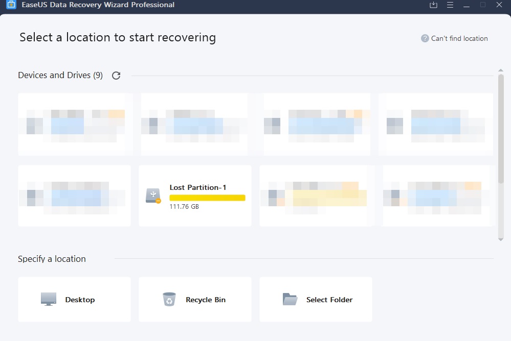

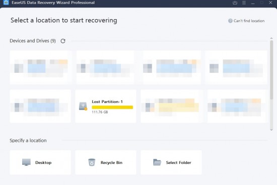

I did mean 712 GB data discovered on the 120 GB drive. Here's the initial interface in EaseUS, only the drive in question visible:

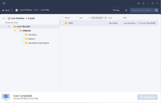

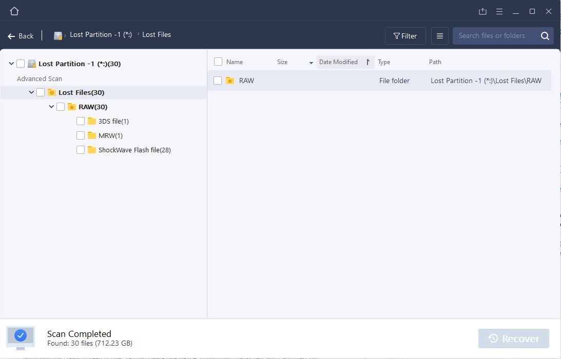

Below is the end result of the scan:

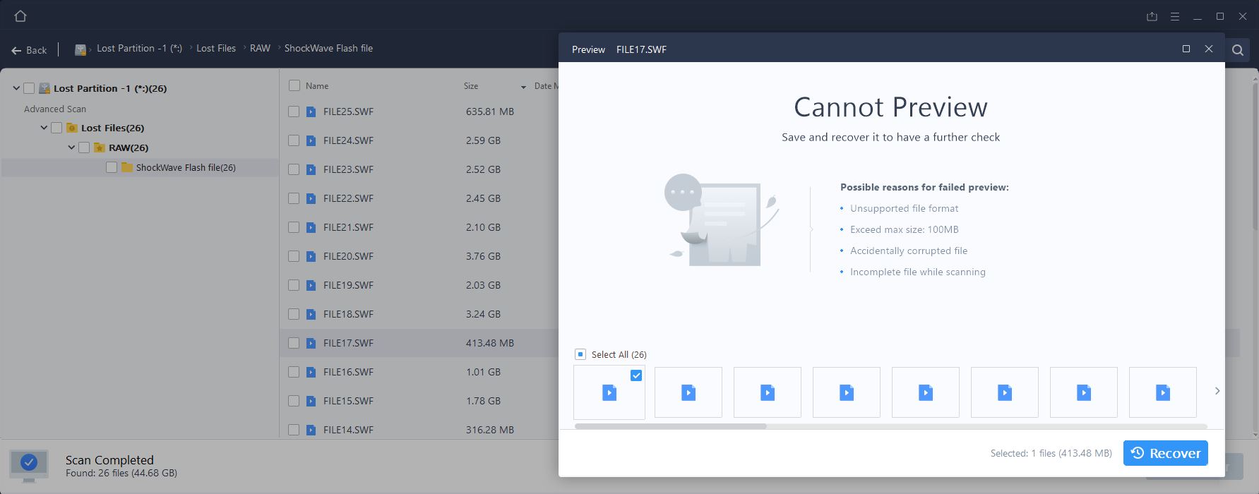

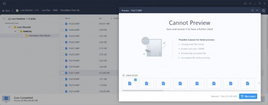

The discovered files are too large for EaseUS to open, it seemingly has 100 MB maximum size of any of the files. Either that, or the file is corrupted. After the Bitlocker partition deleted and did another disk wipe, EaseUS shows this error:
