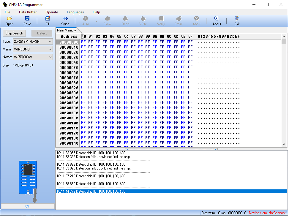

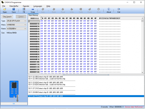

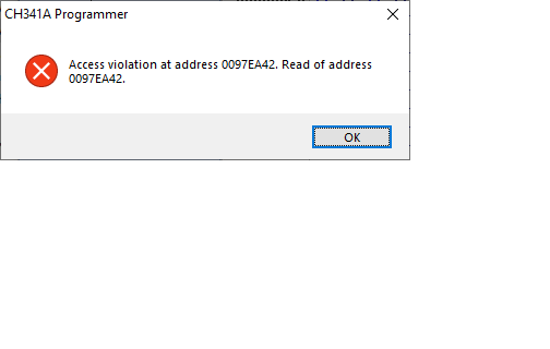

I have a problem reading the 25Q80BW memory with CH341A (+1.8V adapter).
CH341A EEPROM Programmer (software V1.3): I check it with a 3.3V memory, it does work (but it's not able to detect the memory, I have to manual select it). I was able to read/write etc...
I tried to read my 25Q80BW flash memory (not with the clamp) from a donor SSHD (with 1.8V adapter). It does not auto detect it and even if I manual select it's still not working, I get the following errors (please ignore the device state, I made the print screen after I disconnect the programmer from USB):
The memory is still ok, I solder it back to the PCB and the SSHD it's working.
Do you have any ideas? Thanks

AFAIR, the software won't autodetect the chip but if you choose a spi flash with the same capacity, it should read ok.
Are you sure the adapter is working and connections with the chip are good?

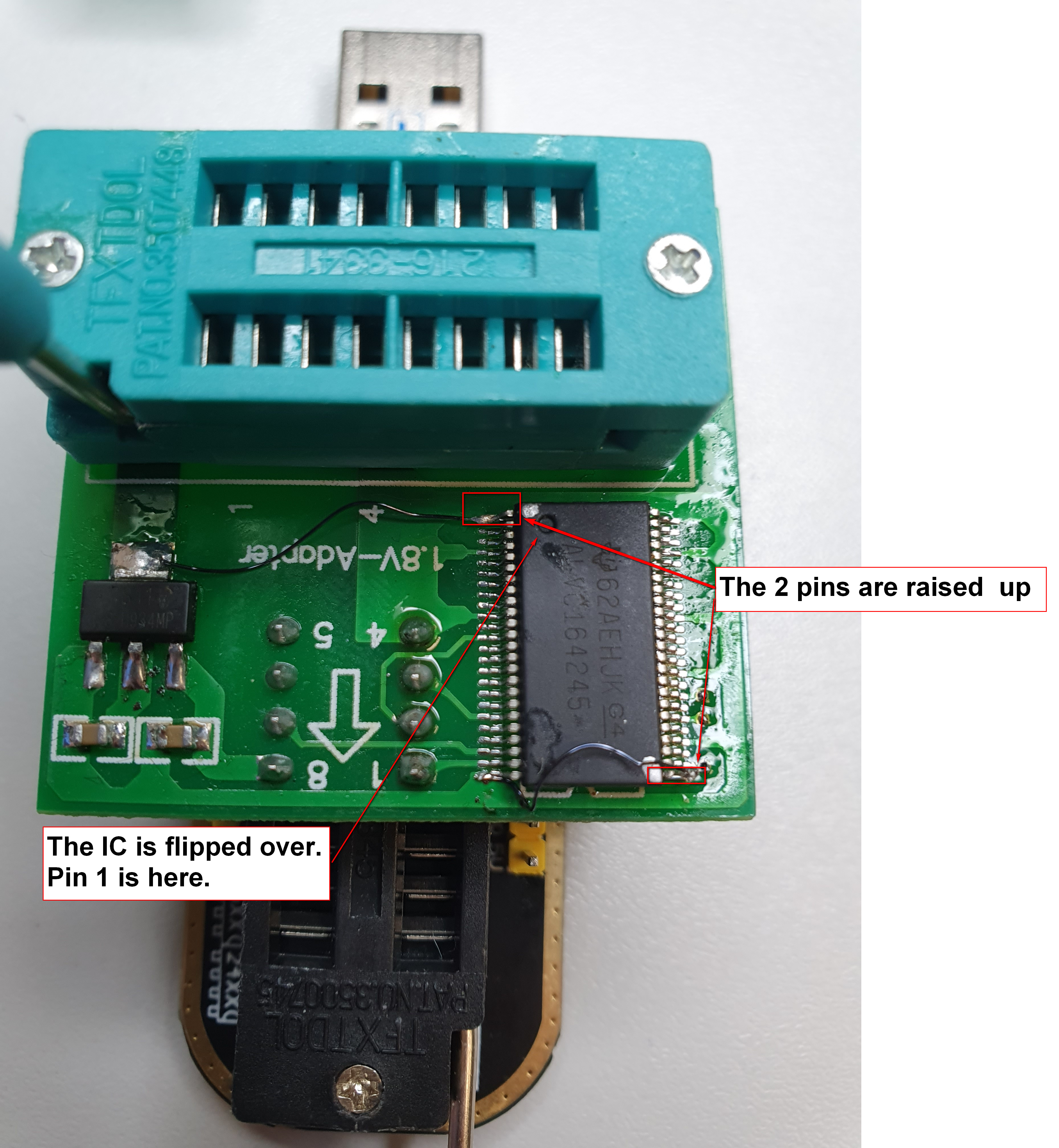

Hello, thanks for reply. Actually it does not auto detect any memory on my side. (I have checked 3 types.) and 2 software versions (GUI).
- 25Q80BW10 is on the list start v1.29 (of ch341a).
The 1.8V adapter design is wrong.(Faulty PCB design or the wrong Voltage Level Translator):
- the Voltage Level Translator is not for 1.8V is 2.3 V to 5.5 V (If I remember correctly). I assume that this IC is wrong on my sample.
- On the PCB the input is connected to the output and the output to input. (probably there is another IC for which the PCB design is ok)
Anyway, I rotate 180' the IC, rised up 2 pins and solder 2 wires and I was able to read my memory. It seams that this IC is working with 1.8V also. (Even that this is not clearly specified in the datasheet)
All the hints above are based on the oscilloscope measurements.
Cheap product = low quality :?
p.s. I saw on other forums that a lot of people have problems with 1.8V adapter. Now I understand way, the designer of product was not able to make a simple schematic and choose the right components (2 components: Voltage Level Translator and 1.8V regulator). I wonder how he/they managed to choose the right regulator :shock: incredible.

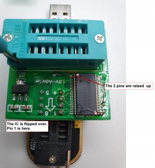

Hi Roots!
I just ran into the same issue. I see you haven't been active for a few months, but I'm still hoping you'll see this..
Can you please explain more how did you fix it? Which chip did you rotate and which pins did you lift and connect? I'm having the same problem and wasn't able to fully diagnose it myself.
I did understand that VccB is being supplied directly 3.3V from my programmer, but according to schematic VccA should be supplied 3.3V if we're lowering to 1.8V yeah?
The chip is ALVC16245.
Thanks a lot in advance man. I hope you see this. :)
P.S if other usesr read this, maybe if you have an idea too how to fix it, I would greatly appreciate the help

Actually I had a notification for this post!
I did not check the entire post, I don't remember the issue here. But, if you are talking about the 1.8V adapter, in the picture you will find the fix.
Remember that the two pins are raised up (no contact between the pin and the PCB pad)
If you have the same PCB layout design and the same IC (check the part number from it) most probably this will not working until you made the changes.
As far as I remember I flipped the chip also, you can easily check this if you compare my picture with your adapter. I raised up 2 pins and I soldered the 2 wires.
Why I have done that?! Again, as far as I remember the PCB layout or de the IC was wrong, this 2 will never work together, because the IC was wrongly supplied. Probably the PCB is working with other IC or this is IC is working with other PCB, what can I say, 2€ adapter, poor design poor tracking of the "project"....
Let me know if everything is clear. And also I would like to know if you managed to fix it :)
Good luck!
Good luck!
Oh my god! It worked! I checked the spec too, but couldn't completely figure out everything myself. Here are pictures! https://imgur.com/a/rAhEvQj
I flipped it completely with a soldering iron, first time also soldering a SSOP48 myself. I can't believe I didn't mess up. Dude roots, thanks so much, I still can't believe you figured it out yourself using the datasheet and scope!
The only thing I figured out myself before finding your post that the chip seems to take higher voltage from B side and lower it to A side, meaning that it wasn't flipped correctly. Then I also figured - if I flip it myself, I'd have to raise the voltage pin too and supply voltage, but I didn't know how to actually change the direction or how to check if all traces were completely good for flipping..
Thanks once again! It works! The chinese are selling flawed 1.8V logic converters everywhere these days! Damn!
