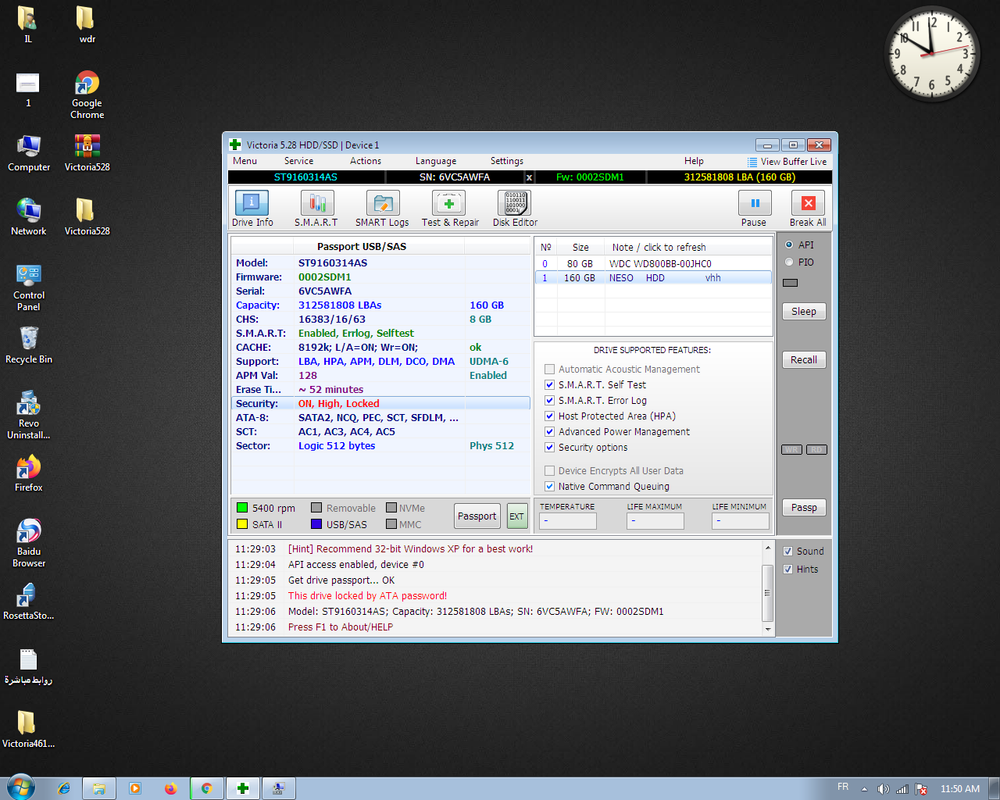

Hello Everyone .... :wink:
Please Help Me To repair This Hard Dick :
Type : HDD Seagate
( I am Not Care About Data I Want Just Fix It )
I Was Try This Method :
https://linustechtips.com/main/topic/96 ... ssword-zu/
But It Is Failed :cry: :cry: :cry:
In The Last Step I See " UNLOCK NOT DONE " ??? I Don't Know way !!! :oops: :oops: :oops:
(This Image Number 3 Not From My Computer It Is Just From Site )
If Any Other Way Please Please Please Tell Me ( I am Not Care About Data I Want Just Fix It )

you could send SECURITY_ERASE_PREPARE and SECURITY_ERASE commands which would erase the data and the pwd. These are std ata commands, i think they are available in MHDD.

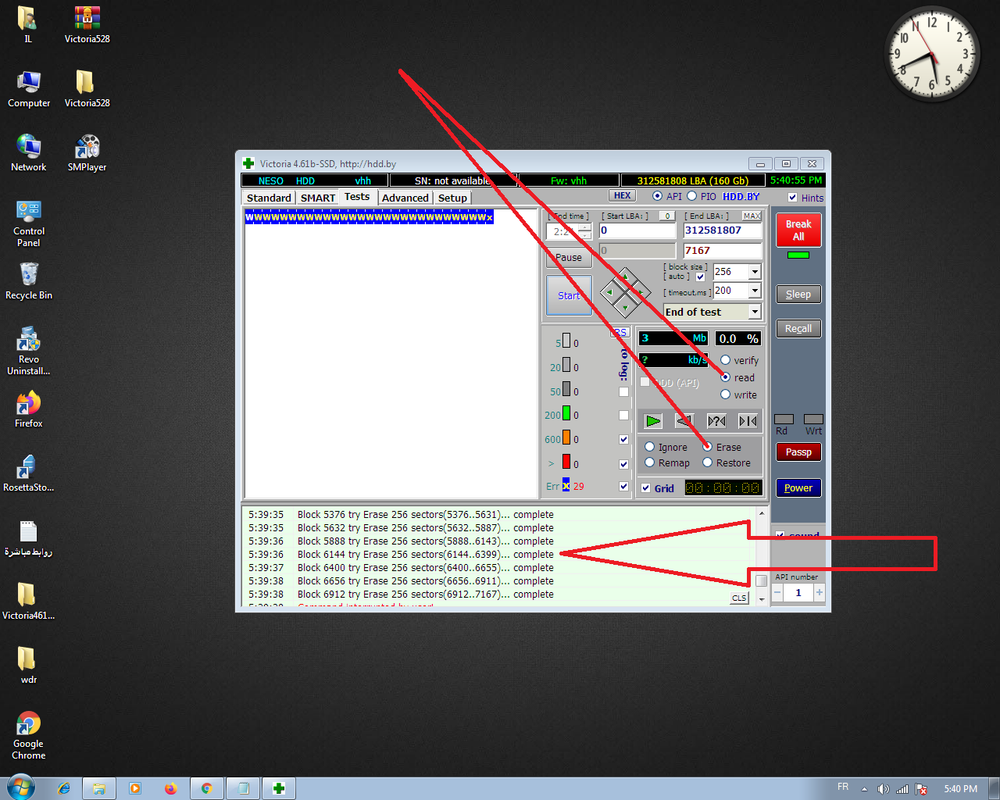

Is This Good Bro ??
Continue Or Stop ?? Please Tell Me

I believe these commands require the user to supply a known password, either a user password (which is unknown) or a master password (which is hopefully still the default).

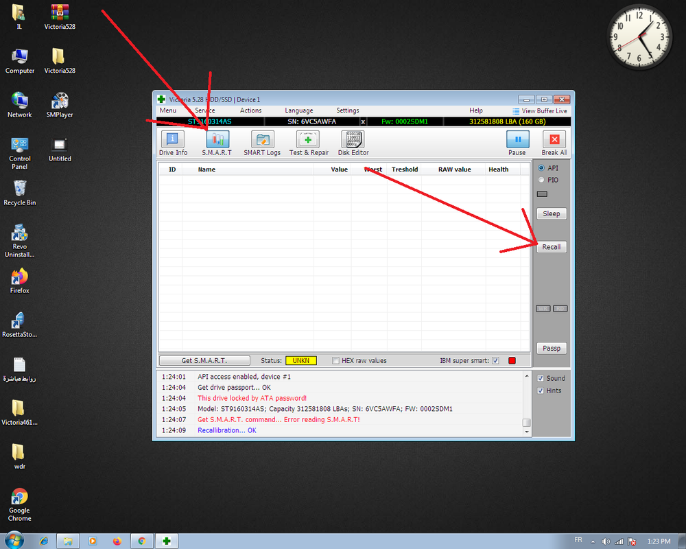

Have you looked at the SMART data? I don't know if that drive will have SMART enabled given its age but give it a go in Victoria. Reallocated Sector Count and Current Pending Sector are particularly important indicators.
 Post subject: Re: Help Me To Repair This Hard Dick Please !! ♥
PostPosted: May 25th, 2020, 9:26
Joined: May 18th, 2020, 13:28
Posts: 22
Location: casablanca
Is This ??
PostPosted: May 25th, 2020, 9:36
Joined: February 14th, 2017, 16:21
Posts: 222
Location: united kingdom
Looks like it can't read the SMART status. I don't know if that is just because that disk doesn't support it or because it's password protected. You could try CrystalDisk to see if that shows the data. You can download it here..

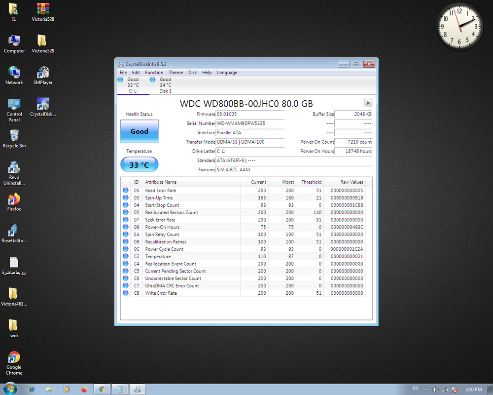

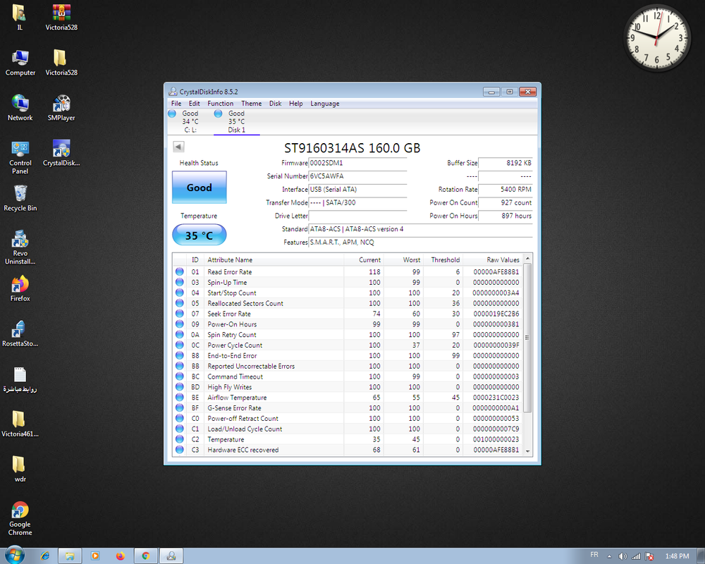

Is This ?? :o
PostPosted: May 25th, 2020, 10:05
Posts: 222
I never trust a disk with reallocated sectors count above zero. The drive is failing and will only get worse. I would never put any data on it even if you get it working. It will soon fail.
This link explains it..
https://harddrivegeek.com/reallocated-sector-count/
PostPosted: May 25th, 2020, 10:21
Posts: 22
So Look This Is My Hard Disk :D ... Look At The Reallocated Sectors Count And Power On Hours :o
