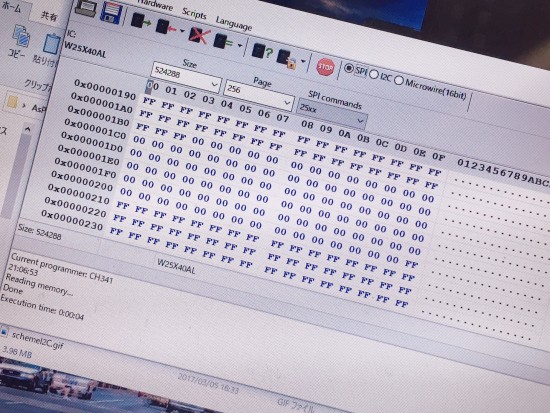

I replaced the ST3500418AS PCB,and I also replaced the EEPROM.
But then I damaged the EEPROM. I think it was because I overheated the EEPROM with a soldering iron.
I think a lot of data in EEPROM is corrupted.
Even if the EEPROM is read, most of the data is "F" or "0".
Will the HDD be unrecoverable if the drive-specific information in the EEPROM is lost?
Thanks for reading this question. If anyone knows anything, please tell me.

melvin wrote:
If the part with RAP, CAP is damaged than there is no way to recover the data. Did you try to read it via programer?
Thank you for the reply:)
I read it using the CH341A programmer.
I'm a beginner, so I don't know the details, but it seems that this ROM does not contain normal data.
As shown in the picture, all data is 0 or F.
File comment: use:CH341A+AsProgrammer

 Post subject: Re: EEPROM damage of Seagate HDD
PostPosted: May 16th, 2020, 10:54
Posts: 4808
Firstly, it is not yet sure the chip is gone. please post the full flash image you grabbed from it, the prev pic shows pretty few of the full range.
Secondly, you should test your setup with a known good flash chip. 25X40 is 2.5V device, not sure if your reader is able to supply 2.5V. I haven't used this prog, neither did such adapter, but i am almost sure it works on 3.3V or maybe 5V.
The readout should be ok on 3.3V i think, but 5V is a way too high for these, so it can damage the flash.
I also built my reader around an FT board but with SW adjustable supply, so that it won't damage anything...
As you can imagine, this writer is operating at 3.3V.
  I thought it could not be read correctly because of the voltage.
  but, even if the HDD is connected to TTL, the message that the EEPROM cannot be read is displayed.
  This also suggests damage to the EEPROM.
And I also destroyed the EEPROM of the donor PCB. (Same reason)
So I can't test the setup.
Full ROM capture↓
https://www.dropbox.com/s/ph1lpzrhlyvg9 ... e.zip?dl=0
  Thank you very much.
PostPosted: May 16th, 2020, 13:43
Posts: 4808
yes, it is pretty much empty.
What was the original problem with the patient pcb?
You could make a test with the donor's rom, wether you can read it.
I checked the datasheet, W25X40 is fine with 3.3V IO, so you won't cause any damage with 3.3V.
What i think is that it got overvoltage from outside, perhaps the PSU voltage went up or wrong PSU connections resulted in 12V suppiy instead of 5V, but these are just suppositions.
The preamp is subject to damage if the drive suffered such overvoltage, so it must be checked before attaching a working pcb.
