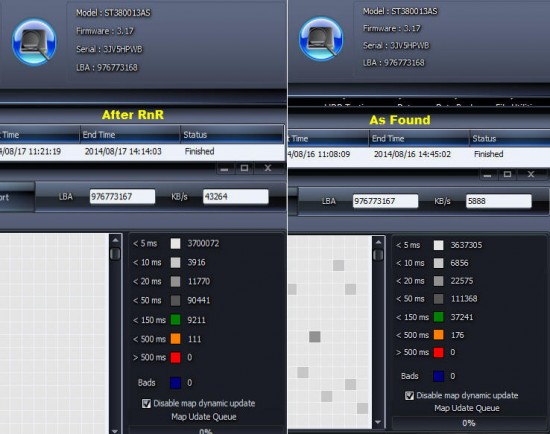

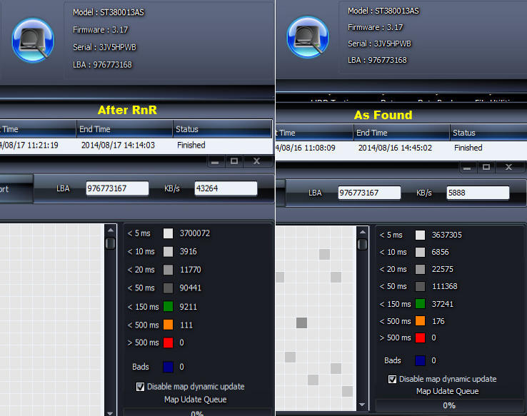

while I am a newbie (actually no experience in head replacement at all tbh), what should I acquire first? the ramp version or the e-type (unstick)?
Given your admitted lack of experience, I would suggest doing head swaps on drives you own until you can do so successfully every time. Only then do head swaps on customer-owned drives.
To track how you are progressing, take one of your sacrificial drives and do a Read/Verify scan with HDDScan or Victoria and take a screenshot of the results. Next, remove the heads as if you are going to swap them to another drive, then re-install them into the original drive and repeat the scan. Take a screenshot and compare before and after results. You should end up with something like the image below.
Do this a number of times with various drives until you feel comfortable doing swaps and results are consistently better or not much worse after the swaps. Then you are ready to do swaps on customer-owned drives of the same models. When you encounter a new model, practice on sacrificial donors of that model before working on the patient.

This is exactly what i was thinking to do in order to learn what i need. I'm downloading HDDScan since it's a freeware. Many thanks for this precious advice.
Although i didn't know about those softwares.
