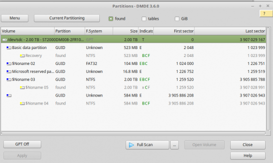

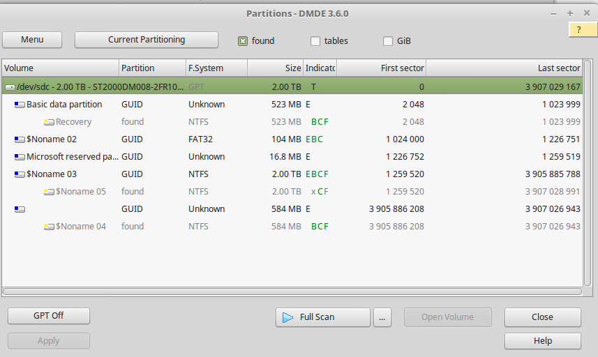

Can you show us DMDE's Partitions window?
https://dmde.com/
If you can see your data partition, d-click it and expand the $Root. Do you now see your file/folder tree?

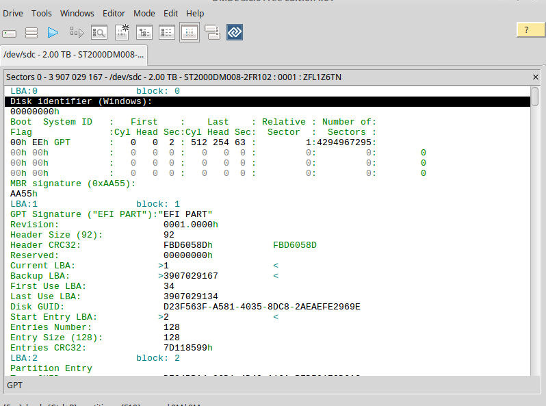

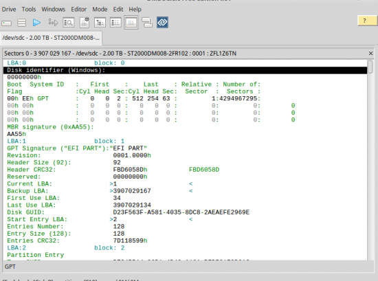

I had a nice old hassle getting the dmde thing. I don't know how to install from a zip. so it's currently just laying there unzipped and I'm running it by clicking on the dmde program file. Probably not the right way to go about it.
and then the screenshot thing - we have to go all through that fishing it out of the menu thing every time... ?
Hope this is helpful. :)
