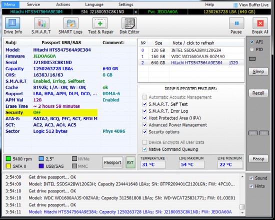

I got this Hitachi HDD with password (I know the password) from my ASUS laptop. Unfortunately my laptop died to due overheating. I tried to attached my HDD to my desktop PC but it never prompt me to enter my HDD password so the drive is accessible.
My question is, is there a software that can access my HDD by entering my password?

Yes many of them, one is pc3000

One thing I'm wondering, I attached this particular HDD to my HP desktop and I was able to access the drive all my files in it without asking for HDD password! Weird.

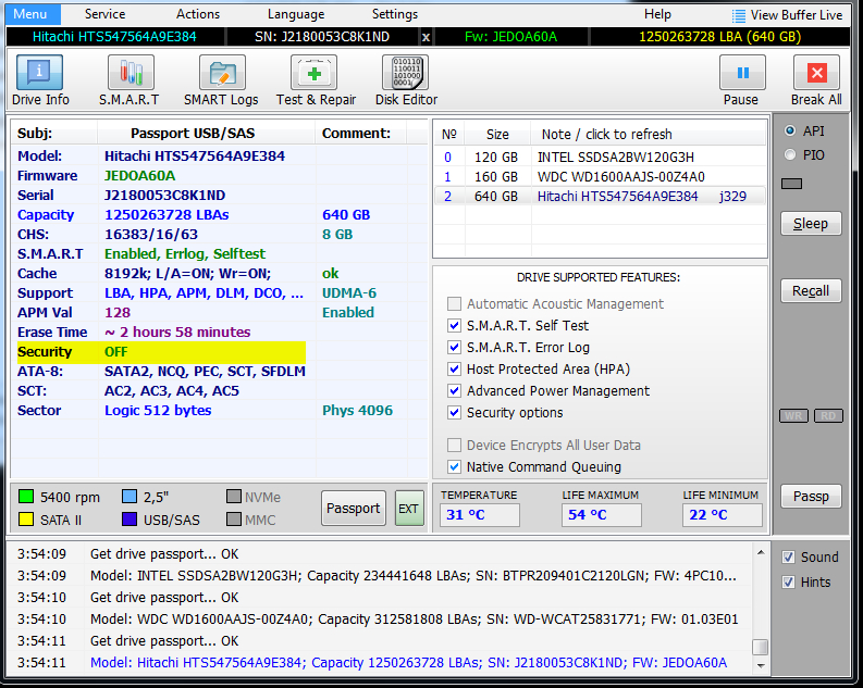

Done it with Victoria 5.28
