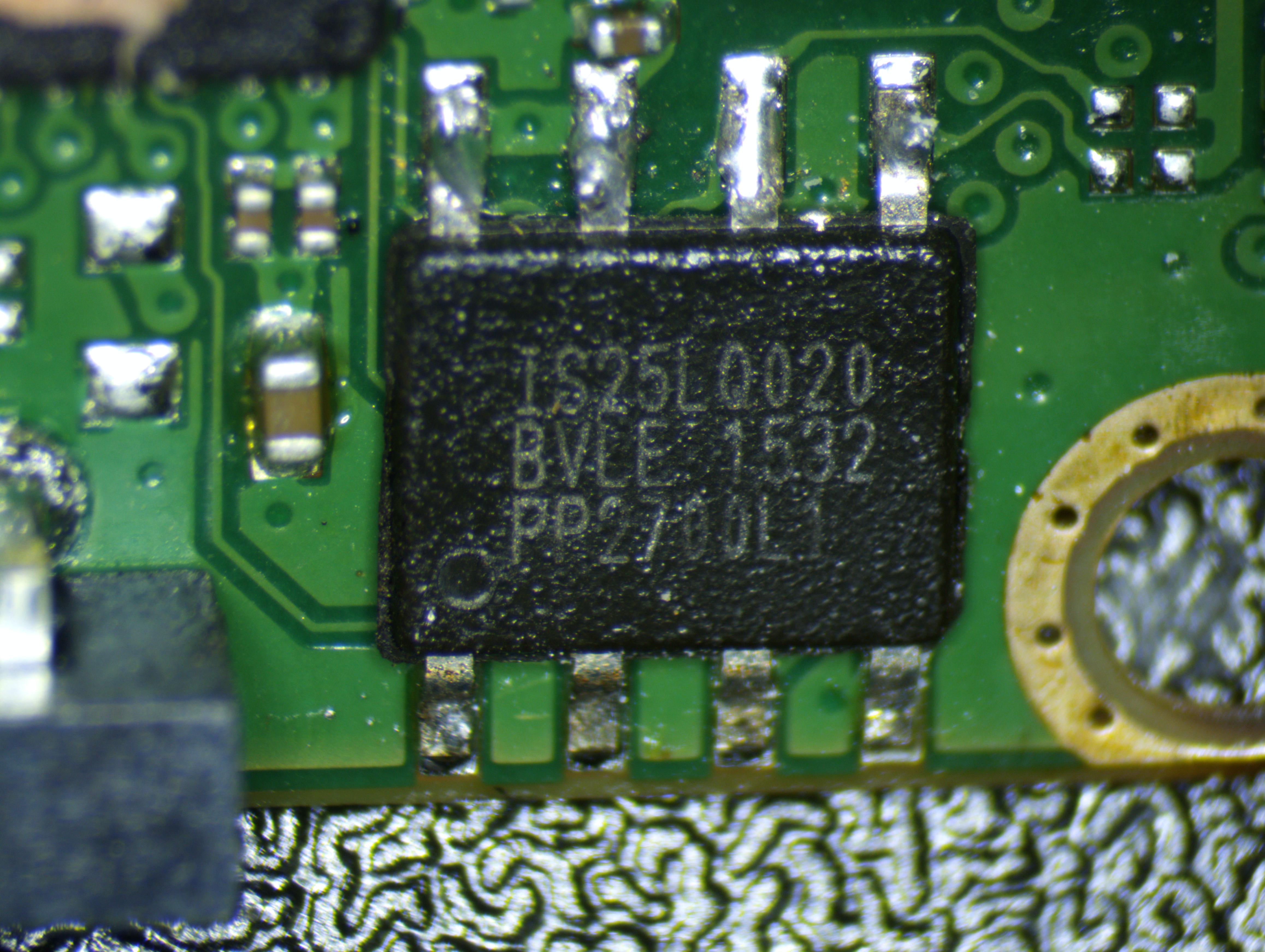

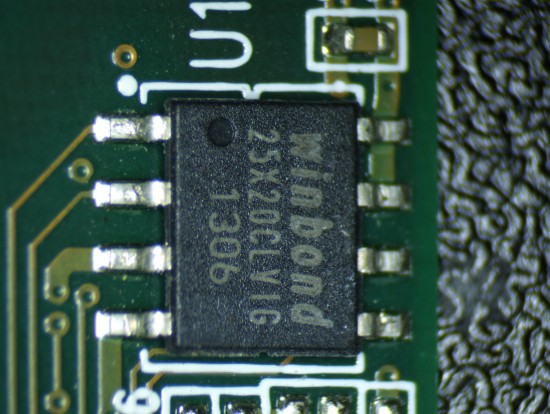

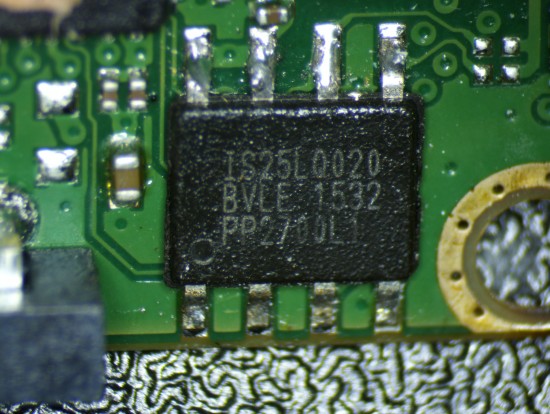

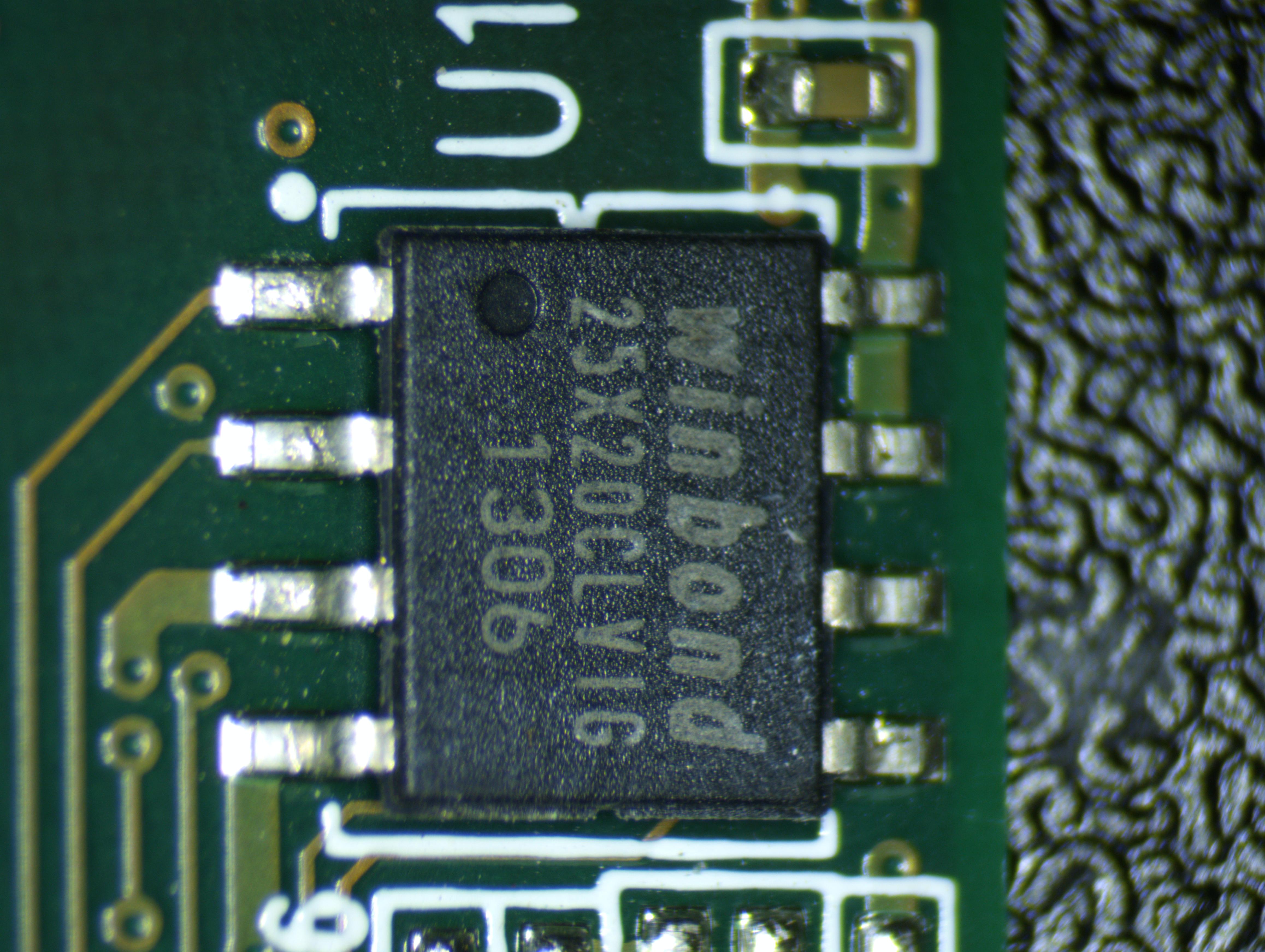

Here are the BIOS chips:
File comment: Succesfully transfer data.
This belongs to a PCB from a 2.5" 1TB WD. The BIOS size reports at 512 Kbyte
File comment: This one is from a WD 3TB 2.5" drive.
Here I noticed the 1024 Kbyte size for the first time.

The W25X20CLVIG and IS25LQ020 have a supply voltage range of 2.3V - 3.6V, so your programmer can handle them. However you still need to make sure that the circuit is designed for 3.3V and not 2.5V.
https://www.winbond.com/resource-files/w25x20cl_a02.pdf
http://www.issi.com/WW/pdf/25LQ040.pdf

Both chips on the pictures are 256KB.
ANY WD 3TB 2.5" should have 512KB ROM chip (and they are 1.8V too, which makes your programmer incompatible with them), I guess you simply reading/writing wrong chips.

@Pc Guard, you can purchase a 1.8V adapter for your programmer. That will enable you to program recent chips.
However, you still don't appear to understand the problem with using 3.3V to program the chip in-circuit on a PCB that may have been designed for +2.5V. Moreover, you still don't understand that it is not the programmer that it seeing 1024KB chips as 512KB -- it is the software, or you, who are responsible for this mistake. You are going to cause your customers a lot of pain.
