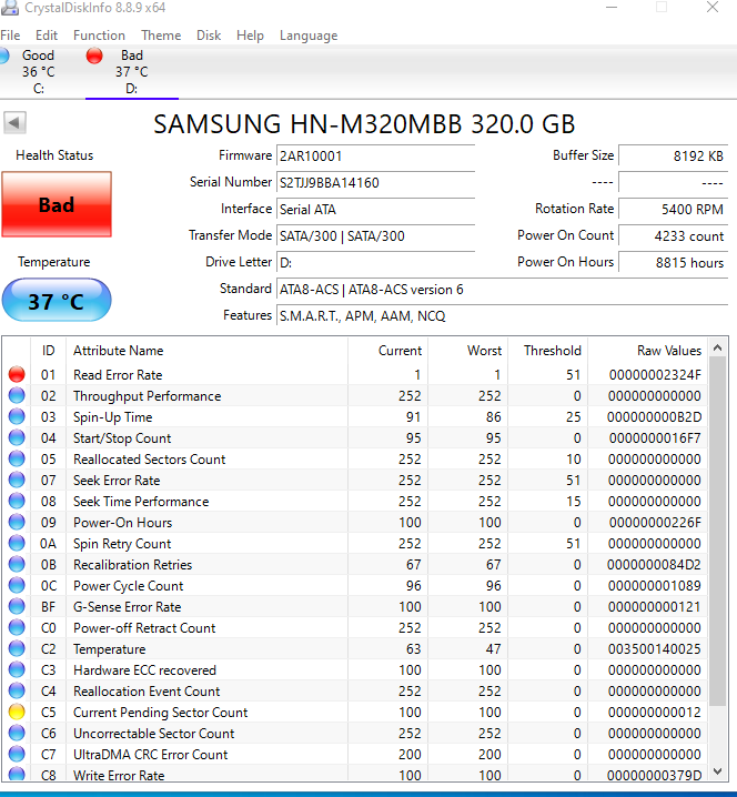

Wait, I forgot to add. I suddenly remembered these.
Maybe these will provide some useful information.

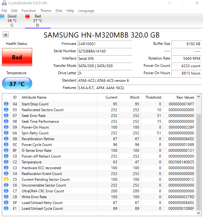

This was the smart CrystalDiskInfo from Windows of the Samsung Source drive back when I haven't heard of hddsuperclone yet.
 Post subject: Re: Samsung and HDDSuperClone concern
PostPosted: February 13th, 2021, 23:37
Posts: 992
The SMART status just indicates that the drive is failing. But you already know that. There is nothing else useful about it, as it is not capable of providing any info on what the failure actually is.

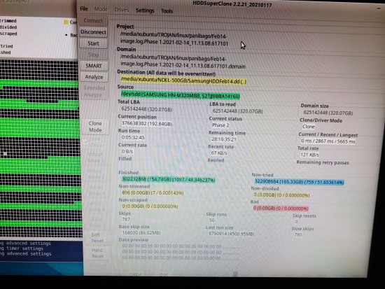

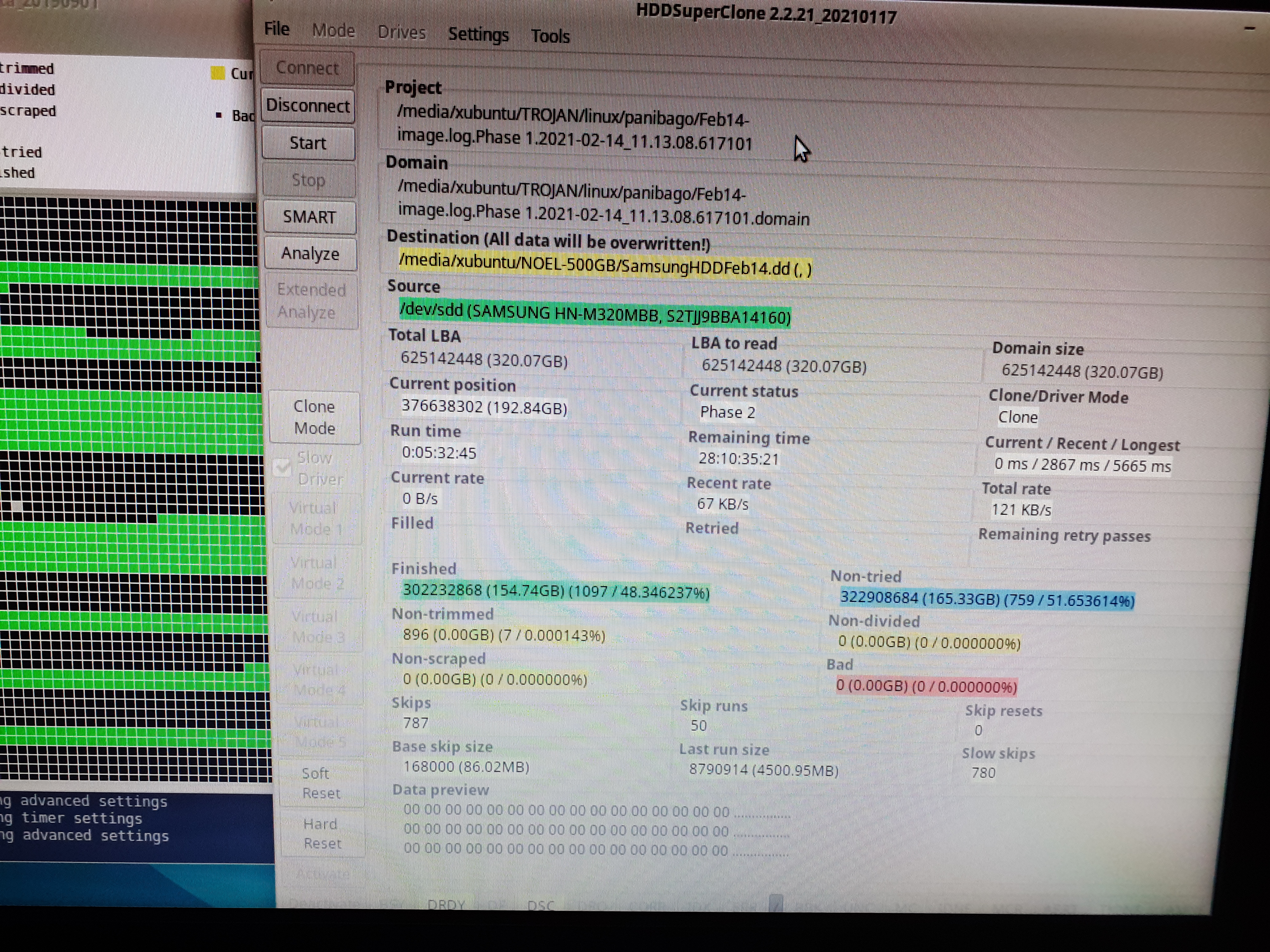

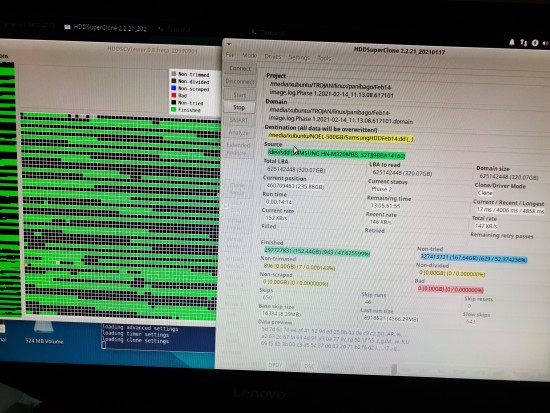

Screen display of 1st run (2 hrs in)
so....after a couple of hours cloning, a power outage shut my computer off and I'm not quite sure to what position it stopped after the sudden shutdown. But it seems the drives are still functional after the incident
I then tried making a backup of the ".bak" file of the original "Feb14-image.log" log file to my Windows pc in case something happens again.
But then chkdsk kinda destroyed the original bak file without me knowing.
Thank God, there is still a bak file that remained other than the main one,
which is "Feb14-image.log.Phase 1.2021-02-14_11.13.08.617101.bak" and I used that for the next re-run.

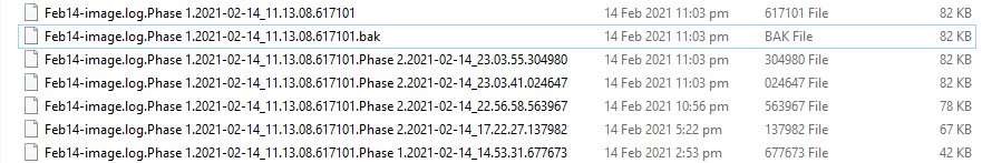

Here appears the new weird progress log filenames after repairing them via hddsc.
This is where I got confused, how do you differentiate which is which?
For the 2nd run (the run after power outage), I picked the only remaining ".bak" log file
"Feb14-image.log.Phase 1.2021-02-14_11.13.08.617101.bak" because it seems the most recent among the four.
What's the difference of this with the ".617101" log file anyway?

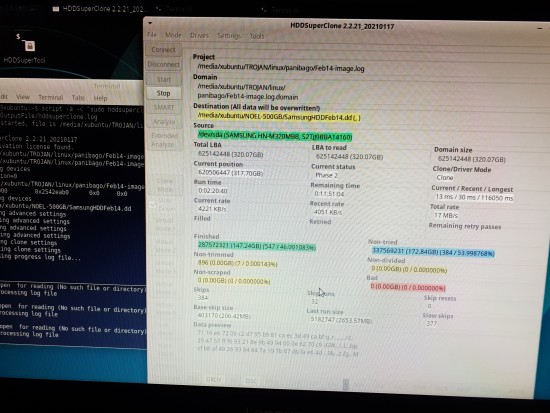

Screen display, 14 mins after the power outage (2nd run)
Screen display, 5 hours after the power outage (2nd run)

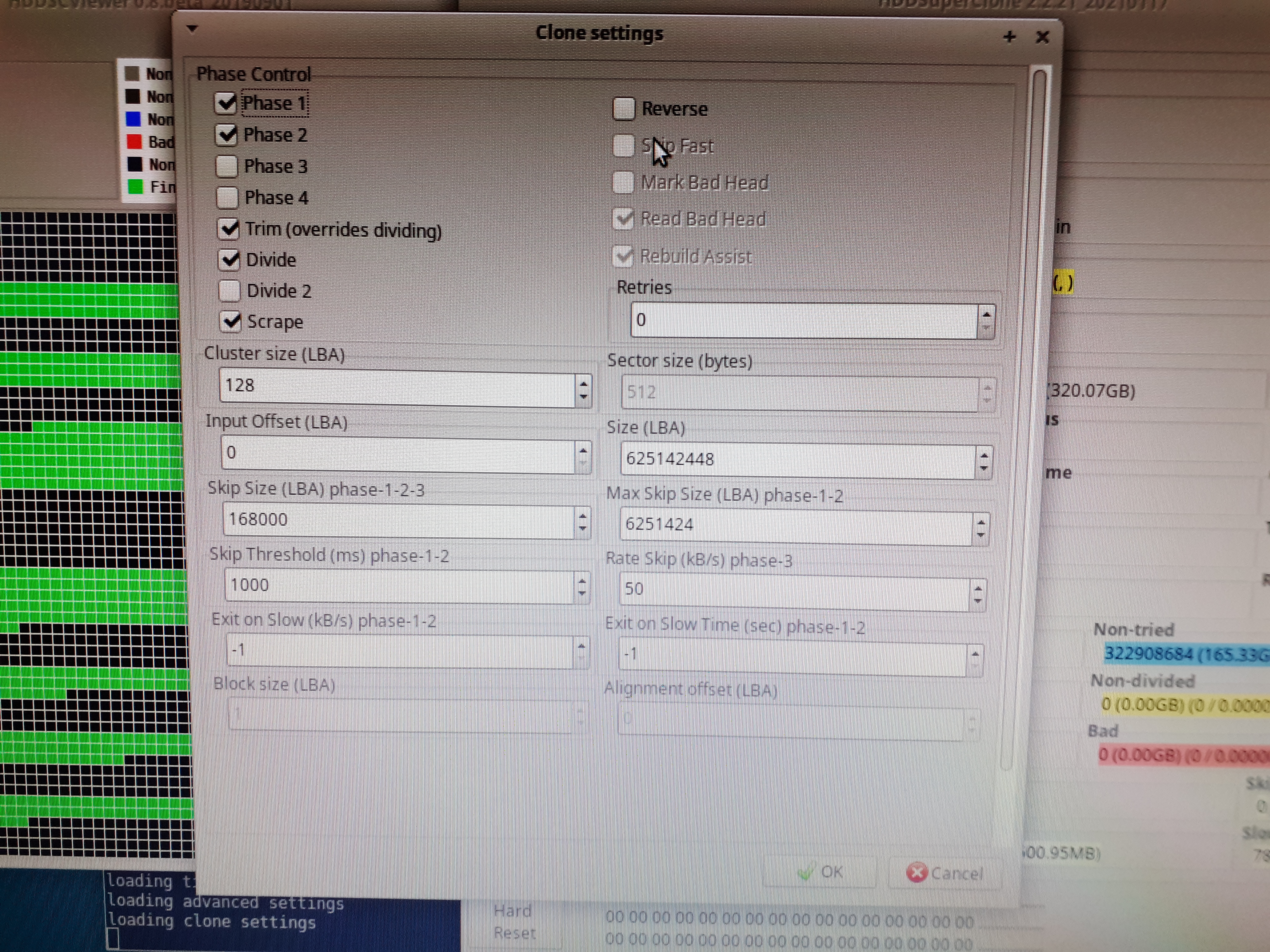

The skip size has also increased even though I didn't change it, how did this happen?

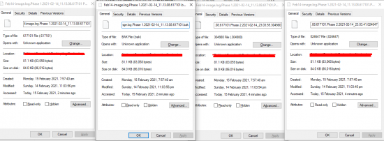

The progress log file ".bak" file (I renamed it to ".log" because .bak isn't allowed here)
Feb14-image.log.Phase 1.2021-02-14_11.13.08.617101.log [81.11 KiB]
Downloaded 1031 times
Why is the "size on disk" smaller than the actual file size, is this normal?

Is there any way to speed up this process?

TL;DR
Head - looks weak rather then completely dead though, you may get lucky if you just wait it out. Untick the scrape/divide/trim, Id bump the skip threshold to 5000 and fully complete phase #2 if you haven't yet. Phase 3 even with the default settings will show if the head is dead or not if none of the black area gets filled in the first 20%. If you start getting data in the skipped areas we can tweak the settings to balance performance / recovery, 50-600K is far better than nothing and a lot cheaper than a head swap.

If you look closely, the phase log file name tells you what phase it was at the end of (or currently in if the program was stopped), and the rest is a date-time stamp, so you can tell exactly what time it was written (down to the microsecond). And if you had to use one for recovery because the original was lost, you should have made a copy of it and then renamed the copy to the original name. You are making a mess of file names that is hard to understand. And when you lost the .bak file, what about the original file “Feb14-image.log”, did you loose that too?
The skipping algorithm changed the skip size. The original size is still remembered in the settings in the log, as the min skip size.
The size on disk is smaller because of how the writes are done. The file is “sparse”, meaning the 52% that has not been written. If you were to read an area of the file that has not been written, it would read as zeros. If you make a copy of the file, the copy will inflate to full size.
You need to uncheck Trim, Divide, and Scrape. When I said to only do phases 1-2, I meant uncheck ALL of the other phases. If it has got into trimming, you need to stop. If not, then uncheck everything except phase 1-2 and continue until phase 2 completes. Phase 2 is a compliment to phase 1 to get the most data out of the good head.
More in another post after I look at the log.

Lardman wrote:
TL;DR
I don't agree with bumping up the skip threshold, that will stop skipping and defeat getting the most good data first, and make the rest of phase 2 take much longer.
Once phase 2 is complete, then you should uncheck phases 1-2 and check phases 3-4. It may then also be time to test whether or not increasing the clustersize helps or not. Run it for a few minutes and watch the speed and read times, then jump the clustersize up. Try doubling it at first, and if it helps keep doubling it until it either doesn't help or you hit the maximum. You want the read speed to increase significantly, but the read times should not go up much. If it doesn't help (or makes it worse), then you probably should turn it back down.
If it does help, you may get a decent read speed. The very beginning of the drive is the worst, but after about the 7GB mark it gets better and seems fairly consistent. Keep that in mind when adjusting the cluster size. Once the position is past 7GB you should be able to see any difference when adjusting.
http://www.hddsuperclone.com
Home of HDDSuperClone
PostPosted: February 15th, 2021, 12:01
Posts: 992
When changing the clone settings (unchecking and checking things), a side effect will be that the min skip size will be overwritten with the current skip size. So before you start phase 3, you will need to change the skip size back to original.
I think I need to figure out how to fix that so it only changes the min skip size when the skip size is changed by the user, instead of when any of the clone settings are updated.
