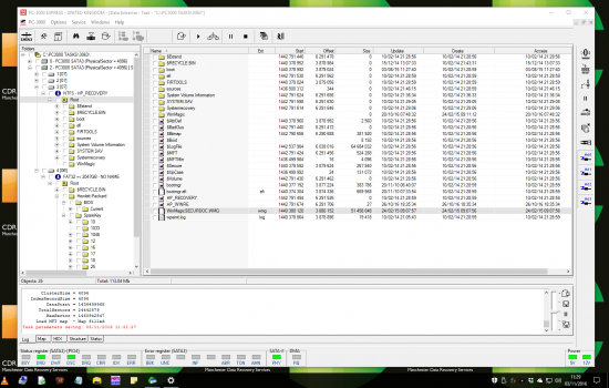

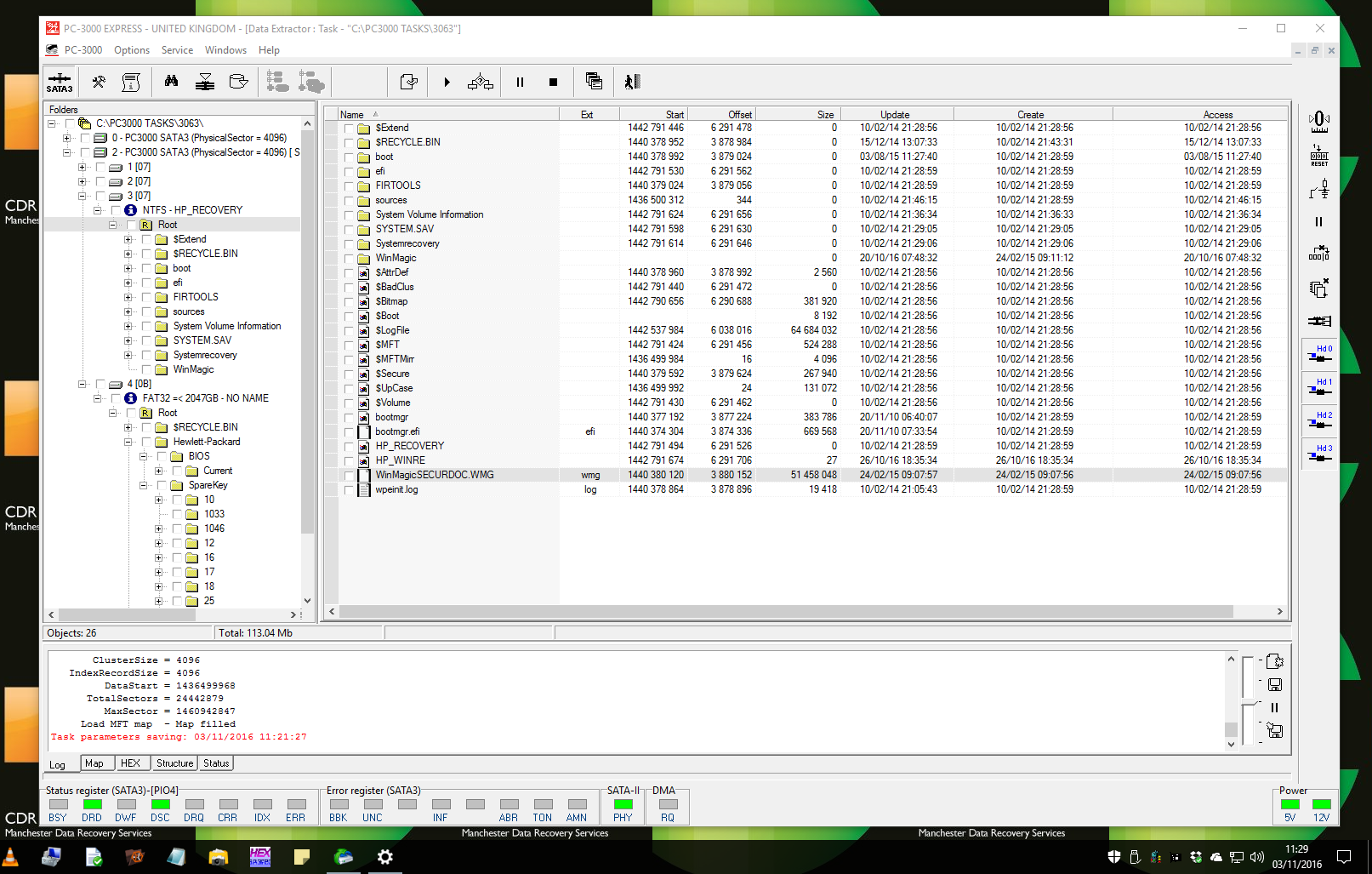

I've had a few WinMagic encrypted drives in before. Yes, it is a real pain to deal with, in particular getting hold of the software to allow decryption (SDWmgRecovery and SDRecovery Plugin). It is not readily available from HP, and as Sean mentioned, WinMagic are not interested.
To decrypt it is necessary to have access to the file "WinMagicSECURDOC.WMG" located on a FAT32 partition on the patient HDD. If it is not possible to get a fully working version of this file then, as far as I am aware, decryption is not possible. That is a forced decryption by password is not an option. Moreover, WinMagic does not save a copy of the WMG decryption key to an external location when encryption is enabled. And of course no user is likely to be knowledgeable or diligent enough find the WinMagicSECURDOC.WMG on the hidden FAT32 partition and take a copy of it when they get the computer new. So if you are imaging a failed HDD go for this file/partition first!
The last WinMagic job I had in (a week or two before this thread) the user of the computer had made various DIY data recovery attempt which had resulted in the WinMagicSECURDOC.WMG being lost (thread: https://forum.hddguru.com/viewtopic.php ... le=desktop). Although it was possible to get a decent disk image of the HDD it was not possible to decrypt in that case.
Today I am looking at another HP WinMagic Drive, fortunately in this case it is possible to locate the critical file for reference of its location see below.
J
Additional to the above - the instructions which HP provide for decryption process are not for the feint hearted! They include a process which deliberately corrupts the BCD which then has to be repaired amongst other things. Again, definitely a job that requires a reserve disk image to back to should it go wrong. Really crap software from HP/WinMagic :)
