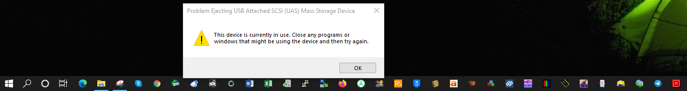

From time to time, I have devices showing the message on the pictures when trying to eject from USB icon in tray. Is there a way to see what process is using the ressources in W10 and macOS, I've google it but result doesn't work here. There no program open on the bar, nothing on the try except USB icon, BT, Volume, Network, Time. As I take no risk... I am shutting down W10 in such case.
Looking at Task Manager, doing ps in powershell, I see nothing.
Sam

Would these tools be of any use?
https://docs.microsoft.com/en-us/sysinternals/downloads/handle
https://docs.microsoft.com/en-us/sysinternals/downloads/process-explorer

as always, thank you. I've tried process explorer, could not figured out what's going on.
I'll do more research and post my outputs here.

1) Download links don't seem to work on the emptyloop.com website.
2) I read years ago that Unlocker was bundled with adware/spyware/junkware ; don't know if it still applies. On Windows 7, using LockHunter which works well for the most part (sometimes it fails to completely unlock a drive because of some very stubborn system process locking it, not sure if Unlocker would fare better in such situations).
3) ProcessExplorer is much more complicated to use than those single purpose tools.
3) No clue about Mac OS.

The software being suggested here are all great for determining and resolving issues of files that are open in a process, but this issue is that of a device being held open in a process.
The reason you don't see anything in process explorer is that generally it is the Kernel that is responsible for the open device.
I sugest using a tool like https://www.uwe-sieber.de/usbtreeview_e.html for such cases, and attempt to restart the USB device from the device tree it displays. If that fails, it also offers the ability to restart each USB port, directly.

IIRC there were some settings in windows to do do with write caching, maybe you can explore that in Google.
