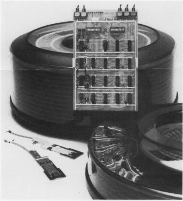

In the next example the file is truncated by half:

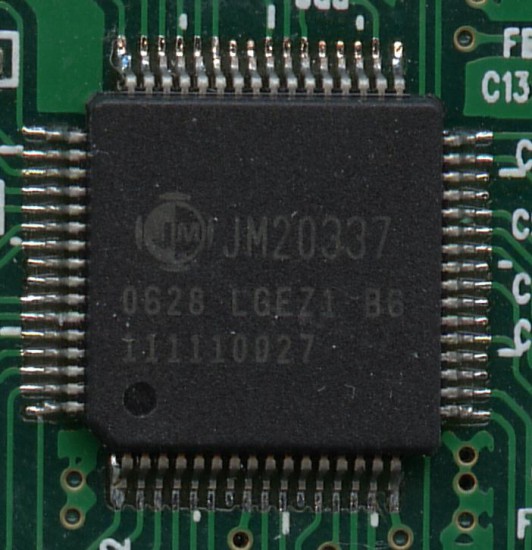

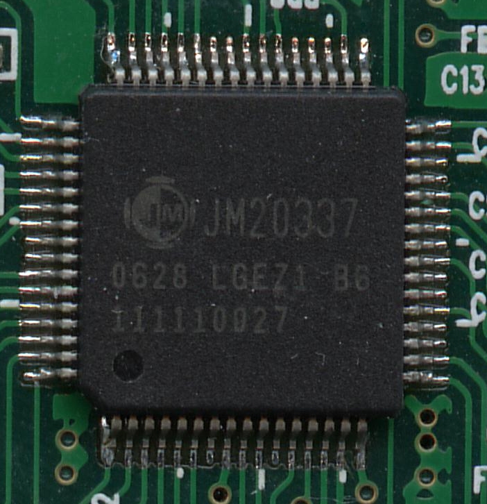

Here the file is truncated to 20% of its size
The point at which successive scans begin and end looks like the following:
0000BEA0  D6 13 FD 5D DE 2D 55 5F DA A7 F2 AF FF C4 00 4A
0000BEB0  11 00 02 01 02 04 02 05 08 06 07 07 03 03 05 00
0000BEC0  00 01 02 03 00 11 04 12 21 31 13 41 05 22 32 51
0000BED0  61 10 14 23 33 71 81 91 A1 20 42 52 62 B1 C1 15
