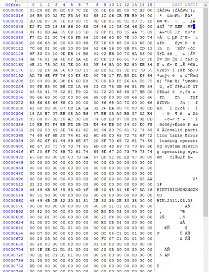

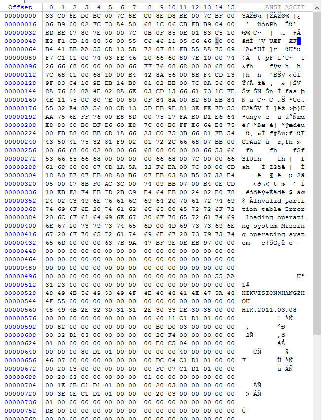

 Post subject: Partition dvr Hikvisi
PostPosted: February 1st, 2022, 10:07
Posts: 1060
hi!
Sorry, tool to recover lost videos on that partition?
Нет ничего невозможного
 Post subject: Re: Partition dvr Hikvisi
PostPosted: February 1st, 2022, 12:05
Joined: May 13th, 2019, 7:50
Posts: 1196
Location: Nederland
https://soft.512byte.ua/products/hikvrecovery.html
PostPosted: February 1st, 2022, 14:54
Posts: 1060
ok thanks!
I will test...
PostPosted: February 6th, 2022, 15:17
Posts: 1749
Location: Verona, Italy
As i know also IsoBuster is able to recover some type od DVR partitions, but i don't know if also for Hikvisi DVRs
