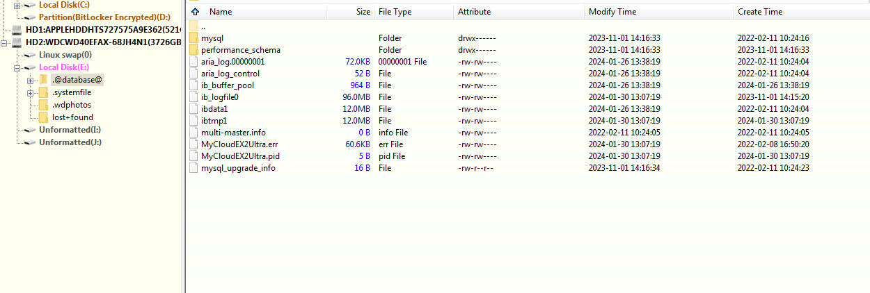

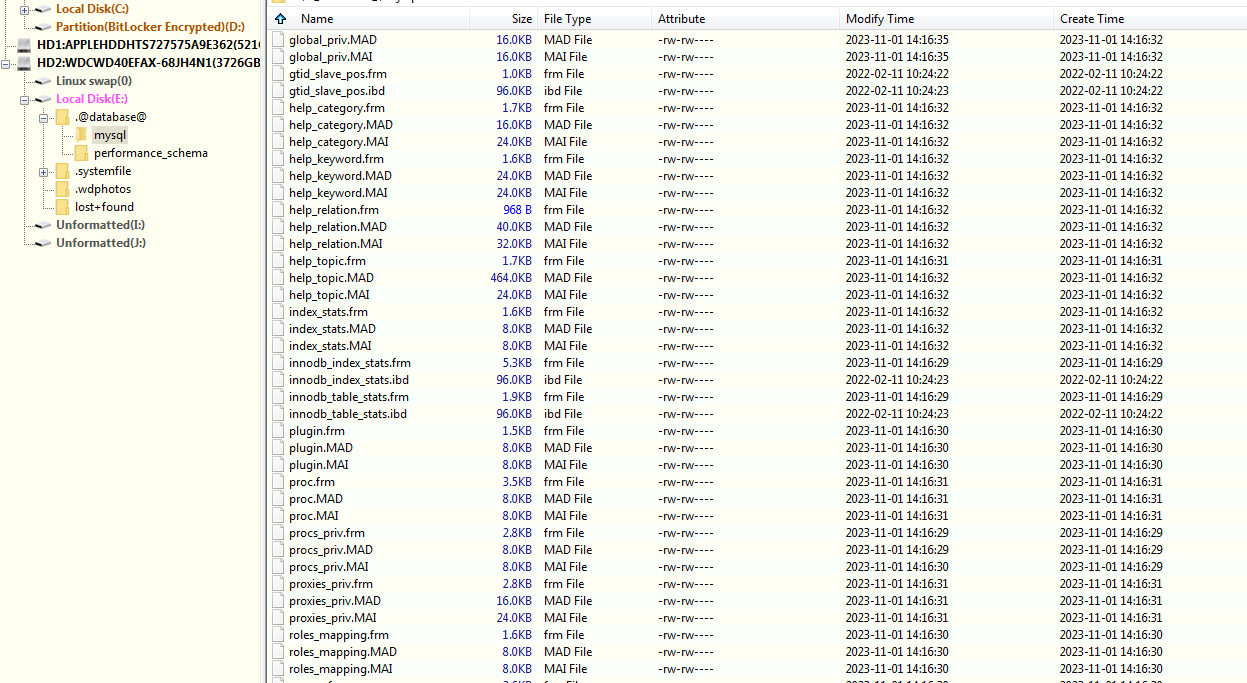

He is correct WD My Cloud NAS storing data in a very new way. I have 2 4 TB NAS drives from WD My Cloud ultra ext2 Raid 1 both drives looks fine the issue is no any recovery software able to find partition or files.
Both drive show same partition table so user information raid 1 is correct, My recovery software detect 1 partition of 1 GB which shows some files and folders, pictures are attached.
I am trying His recovery software but it is not executable in windows need something to run if he can explain in detail. One more thing I notice these drives has no index.db file but index.stat.frm and index.stat.MAD files.

Well, for example, this problem is solved both in the expensive UFS Explorer Professional Recovery and in the cheap Recovery Explorer Professional. To find article just enter to Google "UFS Explorer WD Cloud".

Database file name is different and the above developed program opens but when select drive software turn off automatically. UFS Explorer Professional Recovery not discovering Data folder wise !!
