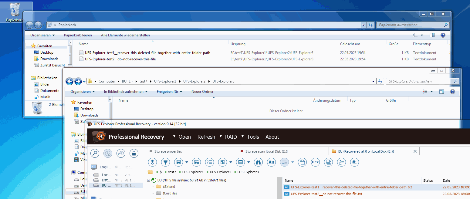

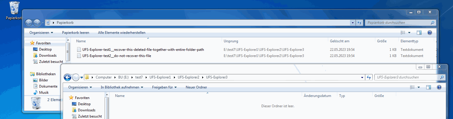

Ok added 2 screenshots:)
Folderstructure an hdd: e:\test7\UFS-Explorer1\UFS-Explorer2\UFS-Explorer3\ (but the 2 files are already deleted and shown in Trash(Papierkorb).
My question:
How to recover the file "UFS-Explorer-test1__recover-this-file-deleted-file-together-with-entire-folder-path"
with the original folder structure?
Thank you!
Harry

Scan E drive for NTFS file systems.

I hardly even recover 'deleted files' or a single deleted file but I managed to by:
My question:
You right click \test7\ > save with filter tick 'copy deleted files' copies all deleted files + folders.
A tad clumsy I agree.
And next time you share a screenshot, share the entire screenshot please and not just what you think is relevant.
