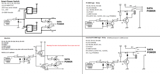

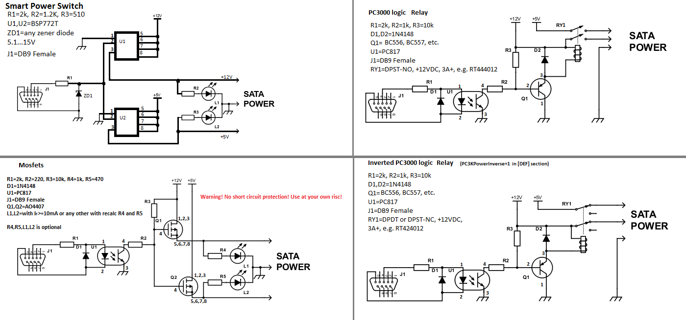

I use sediv. Is it necessary to use a special equipment to use the COM Power feature?
Does anyone know how to connect the device to the hard disk?

I think this is the hardware:
BSP772T, Infineon, Smart Power High Side Load Switch, 34V, 2.6A, 60mOhm, PG-DS08:
https://www.infineon.com/dgdl/Infineon-BSP772T-DS-v01_01-EN.pdf?fileId=5546d4625a888733015aadefb07a4c41
