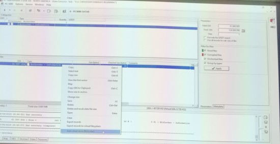

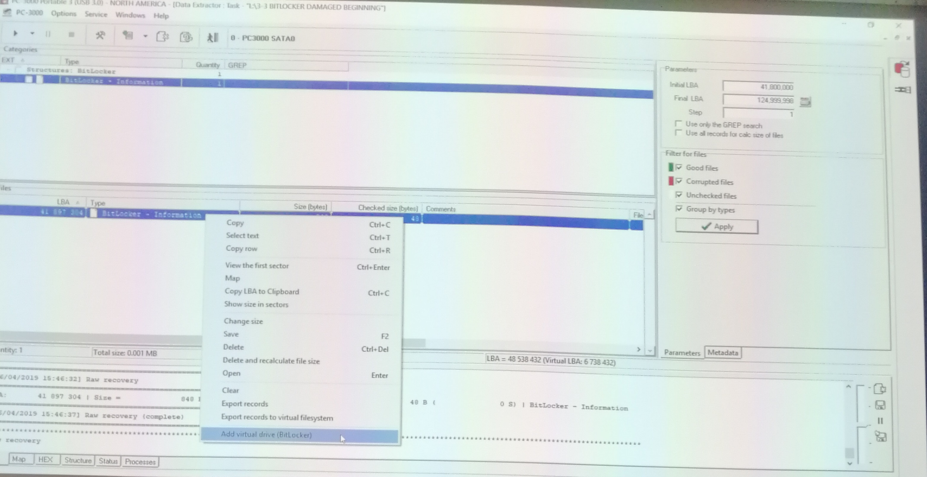

What do you mean by "takes too much time & result was not so encouraging"? If there's no partition info or beginning of drive is unrecoverable you check in RAW if there are any BL informations found in 30% and 60% of drive's LBA and use them if found. Data Extractor can help in those cases. Also it has a database with known keys so it helps with some cases where BL was turned on not by user.

In DE you just scan few milions LBA max to find BL info than use it as virtual drive. Takes few minutes max.
Maybe there's something you do different way.

DE is very good with raw recovery. It also gives you good option to create/add more signatures easily. R-Studio also very good with raw.
DE (and UFS) has a very nifty way to add Bitlocker metadata to your search and create BL partition and extract data from them.

I believe Ace has documented this in their DE manual, but from memory:
If you raw scan a BL drive and metadata is there, DE will find it. Then, right click > Add Virtual Partition.
