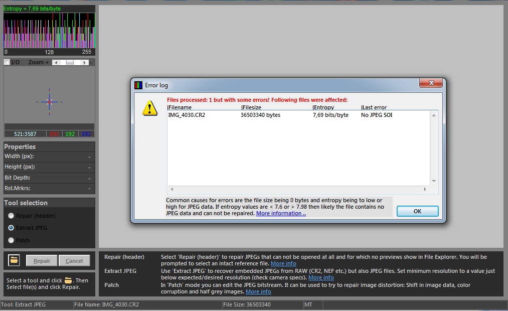

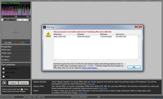

I tried to extract jpg from CR2 that you've passed to me, but they're to corrupt.
On pic above you can see that file IMG_4030.CR2 is very bad so jpegdigger can't do anything!

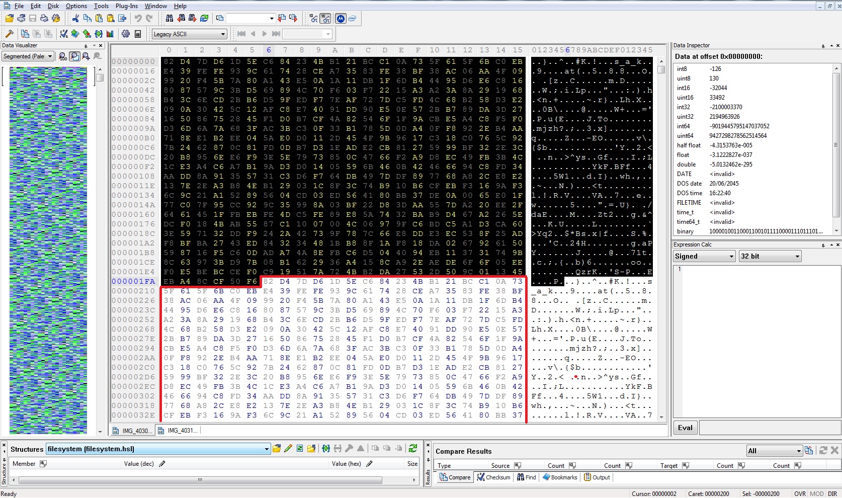

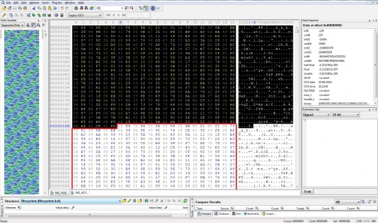

I examinated your bad CR2 files with an hex editor, they have all same issue:
512 redundant byte blocks
Example of IMG_4030.CR2
Those bad CR2 file can't be fixed, they do not contain any useful data!!
This means that all those bad CR2 files were damaged from the font or your data recovery (cloner) tool failed.
Have you done some kind of raw scan recovery?

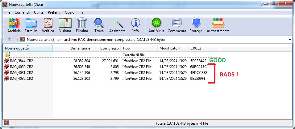

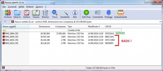

What is the size after compression with 7Zip? If there is that much redundancy, the compression ratio should be huge.

The compression ratio of the good file suggests that the TIFF section is using lossless compression. This would imply that even minor damage in that area would be impossible to repair, I would think.
