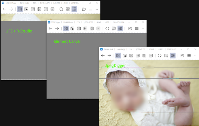

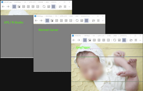

People too often assume fragmentation while real cause may be something else. Like bit errors. Today I got this:
Card imaged over USB, then (left) recovered using R-Studio/UFS (Not sure that was what this lab used last time). I ran Klennet against same disk image (middle), even worse although in this case it does not really matter. JpegDigger recovered most of the file in a repairable state (right), lines can be repaired using content aware fill + bit of clone-stamping.
JpegDigger 'repair' option enabled to deal with issues, that are in turn caused by bit errors so that best part of a file at least displays.

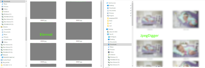

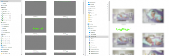

Don't get me wrong, I love Klennet Carver. Just saying, do not assume fragmented files are only thing that produce files like these.
