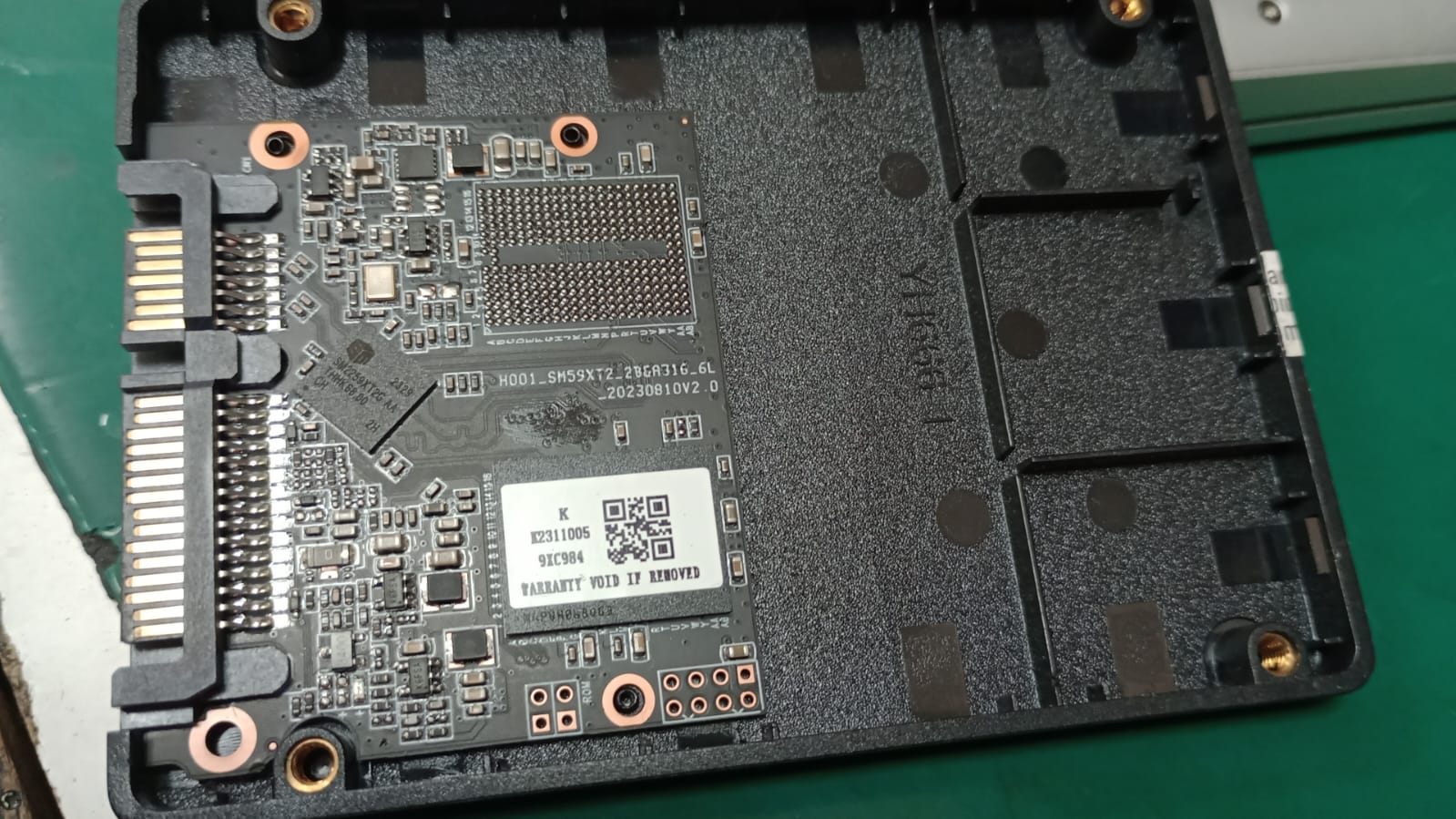

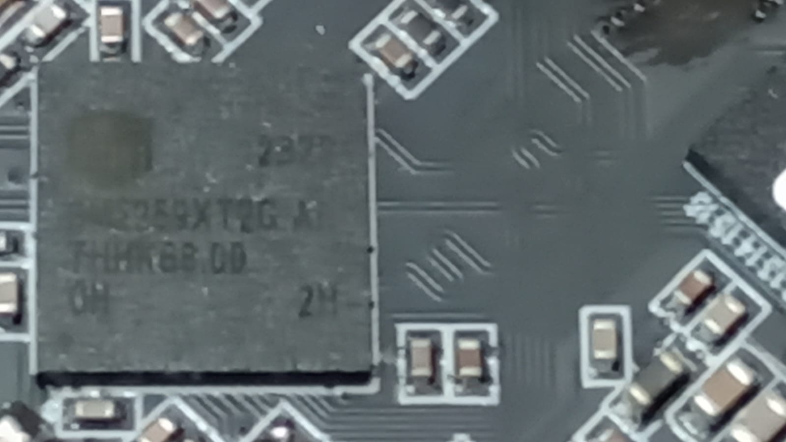

Amigos tengo un SSD TEAMGROUP donde el IC SM2259XT2G AA cuando recalienta ya no es reconocido por mi computadora(recalienta bastante).
Habrá una forma de recuperar mi información, alguien me puede ayudar.
Habrá un software que pueda recuperar mi información por favor se lo agradecería bastante.
Saludos
RICHARD
File comment: Mainboard del SSD
File comment: IC

Is there software that can recover my information
A spesial software, yes. It's not available for regular user.
Is there a way to recover my information, can someone help me?
PC-3000 can do this, probably. Bring your drive to a nearest data recovery lab or send to someone from it.

There might be some electric fault on the pcb if it heats up abnormally...
a shorted component for example?

Measure the voltages at the inductors. If one of them is too high, that might explain the overheating.
