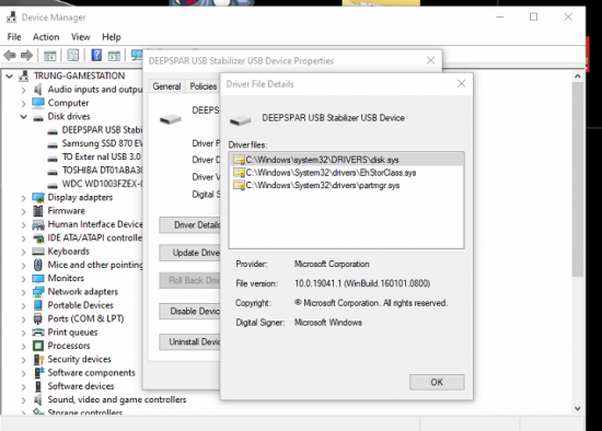

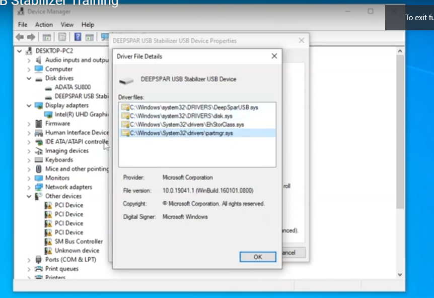

I have a problem with my Deepspar Stabilizer USB device. I am unable to install its Driver through R-Studio. Do you have any solutions to this problem? Can you help me out?
So i haven't been able to upgrade it to Pro as you already know. I have tried Uninstalling R-Studio and updating Deepspar to newest version. However i've encountered a problem and now my Deepspar is not usable anymore

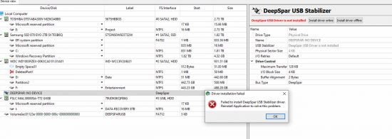

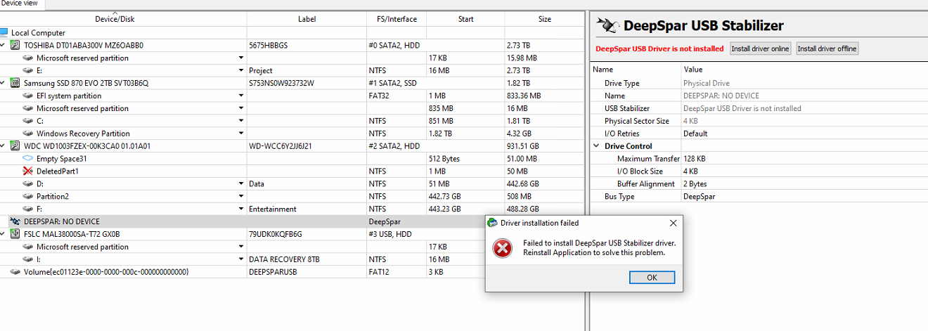

Installing the drive throuh R-Studio online gives notification that it has been completed. However the Deepspar doesn't change from NO DEVICE to recognized. I've tried installing offline and it shows an error message that DEVICE IS NOT FOUND. I have tried installing different versions of R-Studio but still got the same error
Device is still present in Disk Manager

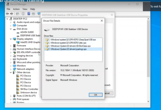

I checked the installation video from Serghei Deepspar and got saw this difference
From the video it has DeepsparUSB.sys

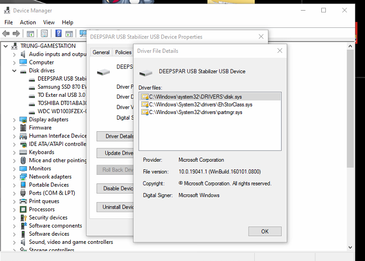

Mine does not have that

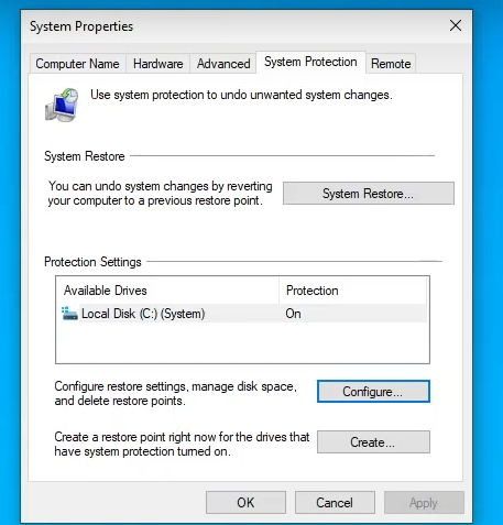

Okay, i found out the problem. And thanks to Serge for the explanation
You need to turn on System Restore for the Deepspar to Upgrade and work properly

One of the first things in manual which I assumed was read. Anyhow, good you have it fixed.
