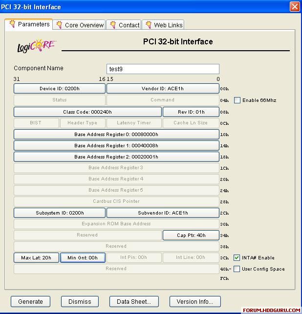

- how to make firmware for this home made pc pci, IP cores from ISE Web ?

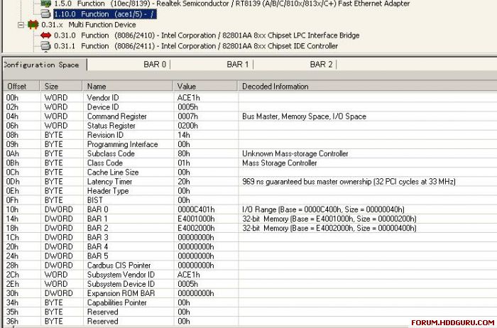

next step: IP Core, set true address of BAR0, BAR1, BAR2

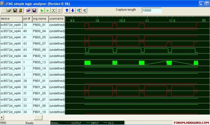

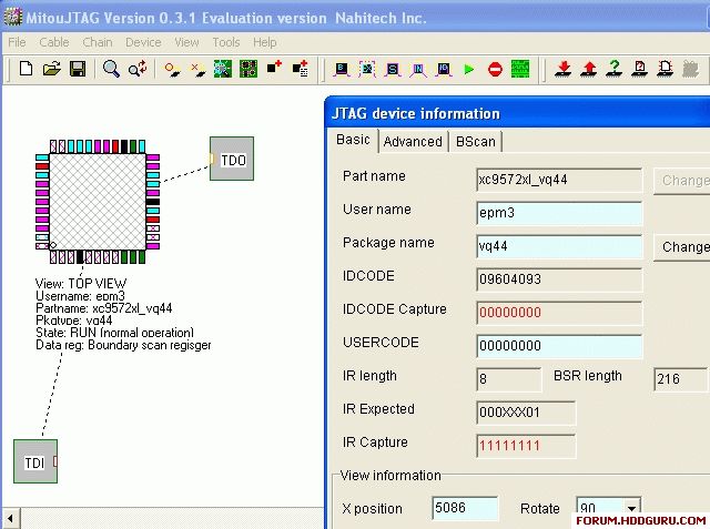

boundary scan by JTAG

- jp2 connector ( DIAG) only connect to 17s200 not xc9572xl.
- 17s200 ( 17s1500 control configuration of xc2s200 Spartan.
- xc9572xl save s/n and some little configuration file, clock.
