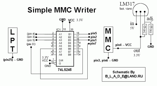

If you cannot find such a card reader - make it by yourself, you should create something similar to SIM-card reader which connected to LPT or COM-port and after that write the program which can send MMC-commands to your card
Re: Password protected memory card
October 29th, 2008, 9:33
Here is manaul of MMC-cards - http://www.jedec.org/download/search/JESD84-B42.pdf
You can find lock/unlock command there
See the picture for example of LPT cardreader
MMC LPT cardreader

Thanks Doomer, I was giving it a fast look, actually, I didn't understand how to send the commands (through a program?), I'll look better later
Hddbug, but if I have the phone, I can unlock the card directly, just as I locked it! The problems is I haven't that phone anymore and I haven't any friend who has it
October 31st, 2008, 15:13
Mr Wolf wrote:Thanks Doomer, I was giving it a fast look, actually, I didn't understand how to send the commands (through a program?), I'll look better later
You should develop a program which will use LPT port data-lines and send serial MMC-commands (sequence of bits) to your MMC-card
